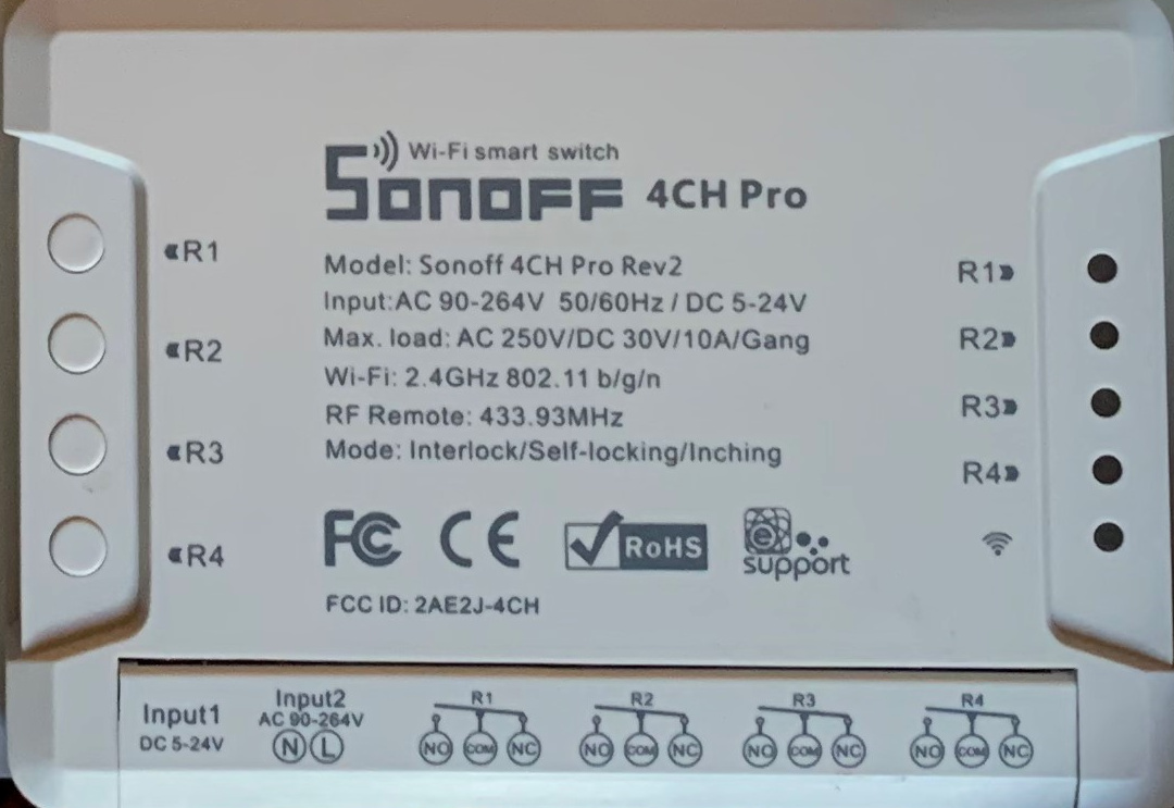

I use a couple of these Multi Switch Sonoff flashed with Tasmota. Is it also possible to implement each switch as a single device?
THX
Yes that’s exactly how it suppose to work when I will implement it. Just need to find time for this.
