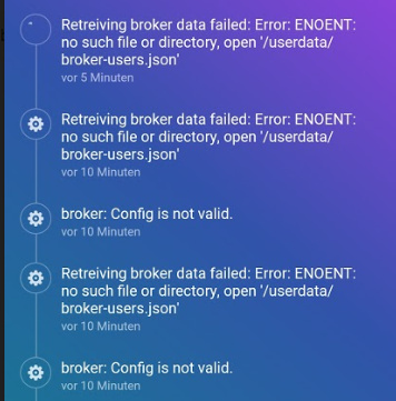

What I just did is deinstalation of the broker, the client and the tasmota app.
I reinstalled everything now I receive those messages here for the first time:
