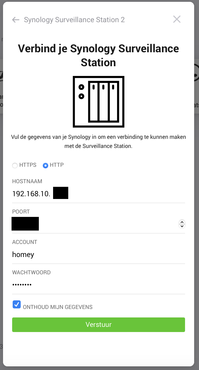

In 2023 I had installed the Synology Surveillance Station 2 app on homey. Then I couldn’t connect to the synology server. Then it turned out that I had turned off the http port, after I activated it it worked.
A few months ago I made a HDashboards and also linked the cameras in it, it worked perfectly.
Suddenly I had a red exclamation mark with my app in homey under devices.
Tried to repair via settings (I found that on the internet) that unfortunately did not provide a solution.
Now I have deleted the app and reinstalled it and I still can’t log in.
Created a new user on the synology Homey and an easy password that can’t go wrong.
via my web browser I can log in to the synology http://192.168.10.X:XXXX (I have changed the standard port number, that was already from the beginning and therefore worked just fine)
In the app on homey I set these same details and still I get the message
[Login failed, check the settings and try again]
I don’t know what else is going wrong now?
@Patrick_Leliveld please translate or remove your previous post as it is not in english…
And about your issue please send a diagnostic report as I can’t see what is wrong right now
For the login you should use the same as your DSM login.

Indeed I use the Synology username and password of the account in the app
