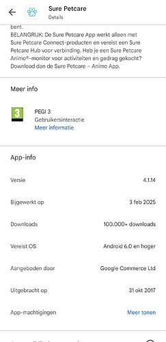

Mine sure petcare app is currently on 4.1.14 (since 3 februari). What is yours.
Rogier
My version is also 4.1.14. However, as previously mentioned, the mobile application is working correctly. I suspect the issue may be related to a recent hub update, which is preventing Homey from connecting. Could it be that you haven’t received the hub update yet, and that is why you are not experiencing this problem?
Okay, so not the same version. The question is, which one is newest? I can’t find any information on which firmware is the newest. Maybe it’s different firmware because we live in different countries; who knows. @Koktail can look at this problem; maybe it’s something in the app?
