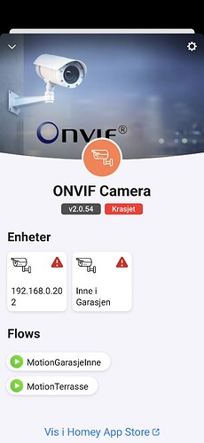

The app, version 2.0.54 has suddenly started to crash. I restart the app, it lasts for a period and then crashes. Nothing has changed in my setup on Homey Pro 2023 (except Homey updates).
For some reason the app is using too much CPU time and being closed.
    stderr:
    CPU Warning Limit Reached
⚠ The app has crashed.
I don’t know why that would just start happening. maybe a camera is having an issue and taking too long to respond or maybe one of the Homey updates has changed the performance. What version of Homey firmware are you using?
12.8.0
