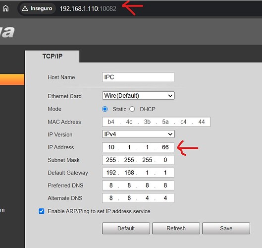

When I connected my izou (Dahua) camera’s I needed to change to motion alert to state before it started working. Other then that it was plug and play when I entered the right password.
Where you did that change?
Thank you
Just to be shure
Which IP adress is the correct one?
And which port?
In de settings of the camera!
The padres you should use is the one you have connected to your nvr. I connected the camera’s separately because the nvr didn’t support it.

Same subnet. The full log is showing a 401 error when I want to add the NVR.
When I try to add one of the camera’s of the NVR to the app I use ONVIF port 65001 the app is adding the device but it’s not working.
The log I have received shows unauthorised, so the camera doesn’t like the username or password you have supplied. Sometimes you need to create a separate ONVIF account, so maybe check the settings on the camera/NVR.
I copied the exact values from the NVR. Do you see any problem in the attached screenshot?
What is strange is the system is refusing the GetSystemDateAndTime which shouldn’t be protected via ONVIF as the time must be synchronised between the two so the digest can be calculated correctly for authentication.

Can you check if http is being blocked by any of the settings?
Could this be something?
I guess that means HTTP is enabled?

So I guess that means HTTP is enabled?
Could you try installing the release version (2.0.48) to see if you are experiencing a similar issue to McFetz?
Hi, I tested with 2.0.51 and still same problem. I shared the full log.
The log still shows an unauthorised error when calling the GetSystemDateAndTime endpoint and that shouldn’t be protected.
The digest authorisation requires the date and time to generate the security key, so the hosts and clients time must be synchronised to generate the correct key, hence that endpoint shouldn’t be protected according to the ONVIF protocol.
So, either the camera is not properly ONVIF compliant or something else is blocked access.
Do you understand why port 65001 is accepted by the NVR?
No idea as it’s not reported in the broadcast data, so maybe the camera is just reporting the wrong port.
Can you use port 65001 and then send the log?
