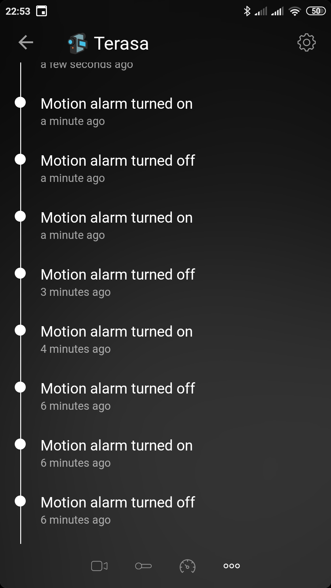

Hi Adrian, came back with my experience. Is there any reason the app shoots motion detections like every 3 or 4 minutes, despite the Dahua app shows me only real deteced motions? I had to disable motion flow as it was constantly giving the notofication :grinning:
Could you enable the logging, restart the app and send it to me after few ‘false’ detections have occurred.
By restarting the app it shows me the event types, etc. that are reported and the notification method.
Done :wink: thank you
Ok, I can see the cameras do not support pullpoints so they are using the new push events, which is still work in progress
The camera also supports lots of event types and at the moment the push notifications are not telling me what generated the event so any one of them is treated as motion.

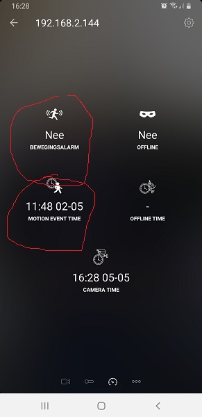

Hi Adrian, I think i have a another problem. When i move before the camera then has movealarm blinking red. By me it doesn’t work. Even the movement event time is from three days ago. See screenshot

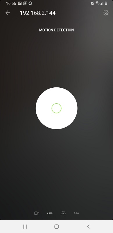

Is motion enabled on the screen to the left?
You mean this screen. Yes
If you switch it off and back on does it start working again?
I have a feeling the camera is using the new Push events which I am working on at the moment.
One of the issues is the call back is not reestablished if there is a loss of connection to the camera. There are a few other issues as well that I am gettings to grips with. So hopefully won’t be too long for a fix if it is what I suspect.
