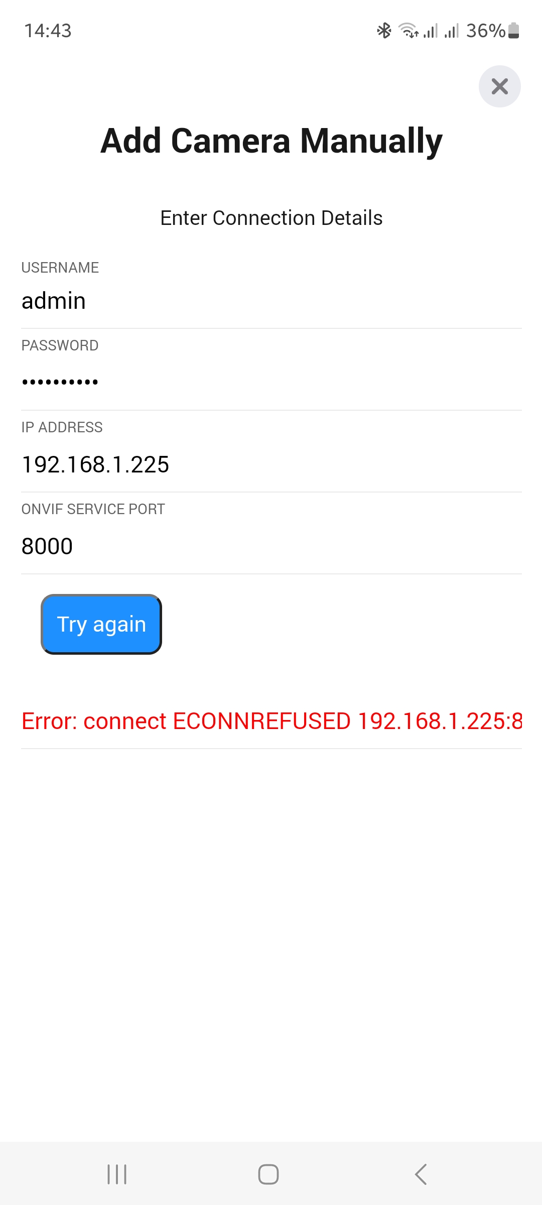

12:43:9.576: Connect to Camera 192.168.1.225:8000 - admin
12:43:9.598:
_request (192.168.1.225): {
ā€œhostnameā€: ā€œ192.168.1.225ā€,
ā€œportā€: 8000,
ā€œpathā€: ā€œ/onvif/device_serviceā€,
ā€œagentā€: false,
ā€œtimeoutā€: 15000,
ā€œheadersā€: {
ā€œContent-Typeā€: ā€œapplication/soap+xml; charset: utf-8; action="http://www.onvif.org/ver10/device/wsdl/GetSystemDateAndTime\ā€",
ā€œContent-Lengthā€: 261,
ā€œcharsetā€: ā€œutf-8ā€
ā€œmethodā€: ā€œPOSTā€
<s:Envelope xmlns:s=ā€œhttp://www.w3.org/2003/05/soap-envelopeā€><s:Body xmlns:xsi=ā€œhttp://www.w3.org/2001/XMLSchema-instanceā€ xmlns:xsd=ā€œhttp://www.w3.org/2001/XMLSchemaā€></s:Body></s:Envelope>
12:43:9.615: Request error (192.168.1.225): connect ECONNREFUSED 192.168.1.225:8000
Error: connect ECONNREFUSED 192.168.1.225:8000
at TCPConnectWrap.afterConnect [as oncomplete] (node:net:1494:16)
12:43:9.620: getSystemDateAndTime error (192.168.1.225):connect ECONNREFUSED 192.168.1.225:8000
12:43:9.624: Connection Failed for 192.168.1.225 Port: 8000 Username: admin

13:14:7.169: Request error (192.168.1.225): connect ECONNREFUSED 192.168.1.225:8000
13:14:7.177: Connection Failed for 192.168.1.225 Port: 8000 Username: admin

Ahha, I think I just twigged. It seems no cameras are being discovered, so did you add one manually?
Yes, manually. No camera discovered.
It may be the http call that fails and would really need https…
Is the camera on the same subnet as Homey?
Just wondering why it’s not being discovered.
And are you sure the ONVIF port is 8000?
Same LAN and subnet, yes.
(I’m able to browse it, right?)
Reolink states ONVIF port is 8000.
Tried a range of other ports without success.
OK, Success!
I’m so happy!
The ONVIF access (and RTSP) was DISABLED by default.
Just Enable RTSP under Network settings Advanced and cameras are discoverable!
Really fun this, already created a set of flows. :yum:
