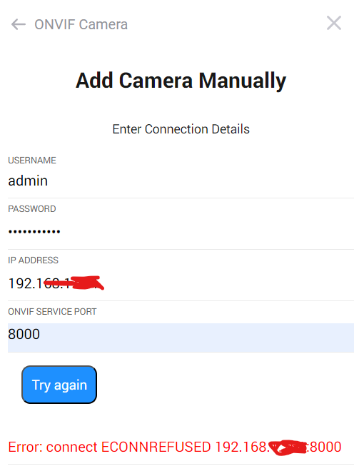

I tried, but I only get refused all the time

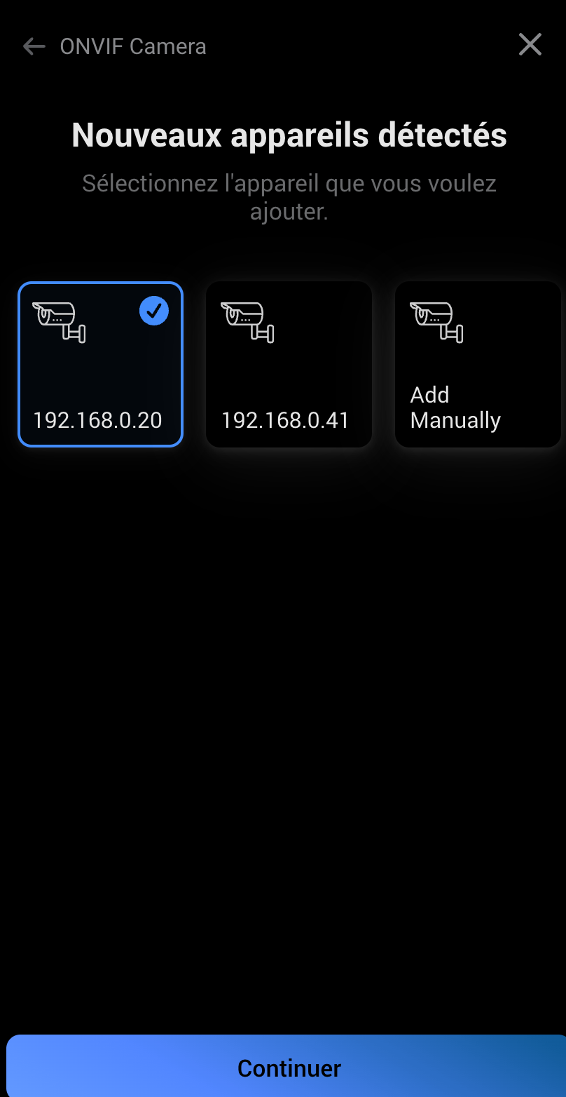

Bonjour,
Je n’arrive pas Ă  intĂ©grer mes cameras imou ranger pro Ă  l’appli Homey pro.
Mes données de connexion
Username : admin
Password : safety code de la caméra ie L21***B7
IP address : 192.168.0.20
ONVIF SERVICE PORT : 37777
Thank you for help
You don’t say what error you see when you try to add the camera.
I don’t see the ONVIF port shown in the picture so I presume you typed that in before trying to add the camera?
Thank you Adrian,
here are the screen shots i get
Good morning
password is the safety code of my camera
the error is “network request failed”

i’ve got the solution using port 80.
well done and thanks for your help

My Reolinks does not get discovered, and the manual connection fails all the time.
Possibly because of the self-signed certificate over SSL (https:).
