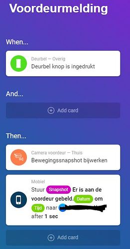

I have a Imou Looc (IPC-C26E) camera at my front door. It is working flawless with the ONVIF app.
The plan is to get a snapshot when somebody pushes the doorbell. I have a conventional doorbell connected to a KaKu ACDB-7000B transmitter.
My flow to see who is at my frontdoor:
“When button is pushed → Take a snapshot from the LOOC → Send snapshot to…”
That all works fine.
BUT: I mentioned that it takes a while before the snapshot is taken; sometimes more the 5 to 10 seconds. When i also take a look at the LOOC under devices it takes a while before i get a image.
But only after i did not use camera for a while.
It seems to me that the camera is falling into a kind of sleep modus after a while. I have searched through all possible settings but cannot find functions like “always on” or something of that kind.
Using ‘motion’ to stay awake is not usefull in this case because my front door is on a private ‘path’ so it cannot see the public street.
Does anybody has a tip or trick to keep the LOOC awake at all times ?
Or is it just the wrong camera for the wrong purpose ?

My flow does not give many options to optimise speed i guess ;-). It is just simple.
BTW: I need the 1 second delay to give Homey enough time to pick up the snapshot (otherwise the picture absent)
But that cannot be the problem. The delay stays at 5 to 10 seconds before the camera responds on the snapshot request.

It would probably be better to split that into two flows. The one above would be the first one, but take out the send to phone action. Then create another flow that is triggered when the motion image is updated and use that to send the image.
Or use the condition card “Bewegings snapshot is klaar binnen” as this will trigger the capture and wait until it is ready before processing the actions. The time specifies the maximum time to wait and if the snapshot is ready it processes the Then section, but if it fails within the time it processes the Else section.

When i use the camera as a THEN action i have for a snapshot only the option: “Bewegingssnapshot bijwerken”.
When i use the camera in a “IF” (ALS) action i see the possibilty of 2 snapshots’:
“Snapshot beschikbaar” and “Bewegingssnapshot beschikbaar”.
Do you know the diff ?
This is what i see in the “IF” section:
But in the “THEN” section i only see the "Bewegingssnaphot:
Maybe there is a little ‘flaw’ ?
Peter
