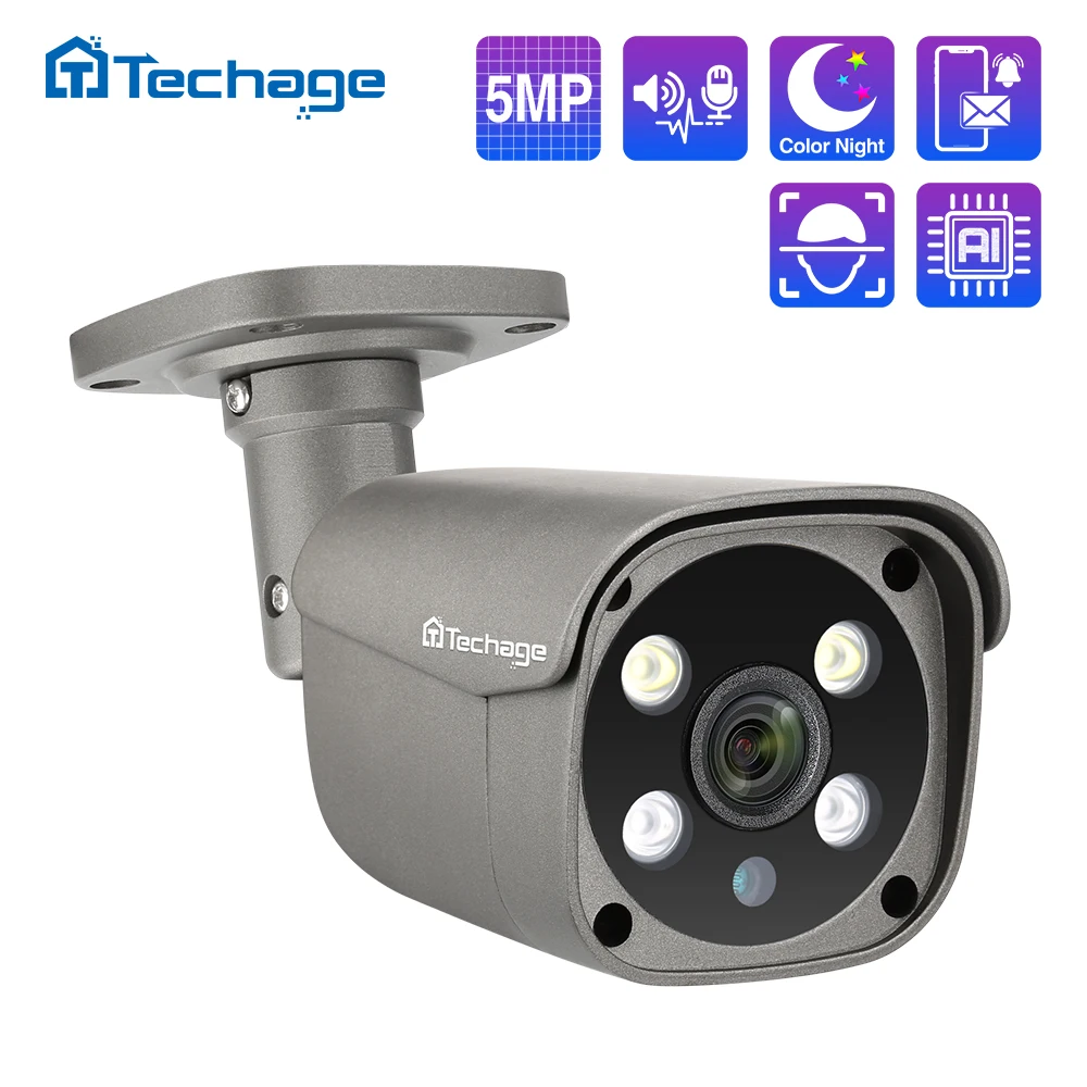

What camera could someone advice for outdoor with url/jpg support and onvif motion detection. In the price range around 40-50euro
Could this be an option
