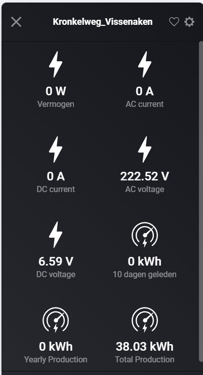

My daily production is always zero and doesn’t seem to refresh. It only updated 10days ago. The other readings (total productionAfter only three days, I only had it at zero.
Do any of you have a reading here?
Updates of “Daily production”, “Yearly production” and “Total production” are irrational at best.
Today, it has been 11days ago they have been updated.
Which inverter model do you have ? Is it a GEN24 ? Thanks
Yes, it is.
Primo GEN24 5.0 Plus
I also submitted a Github request; please let me know if you need anything from me that could be of help.
