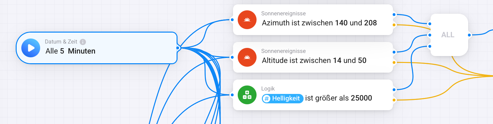

I have a strange issue regarding azimuth and altitude.
My flows will not work after a homey reboot, azimuth and altitude are not matching my ranges
Pushing # Azimuth and # Höhe in the timeline they are correct and within my ranges
If I restart the sun event app . It is working as I expected the values are matching and my flows are working (be true)
I use the latest test version 2.3.10
Attached the app logs
Not working
After restart the altitude and azimuth is as I expected and my flow is working
Deleting the app and reinstall changed not the behavior.
A bug? Or am I doing something wrong?

Still no changes in the values regarding the flow
from 8:38 to 10:40 Azimuth 130.3, altitude 22.52
Am I doing something wrong in my flow ?
