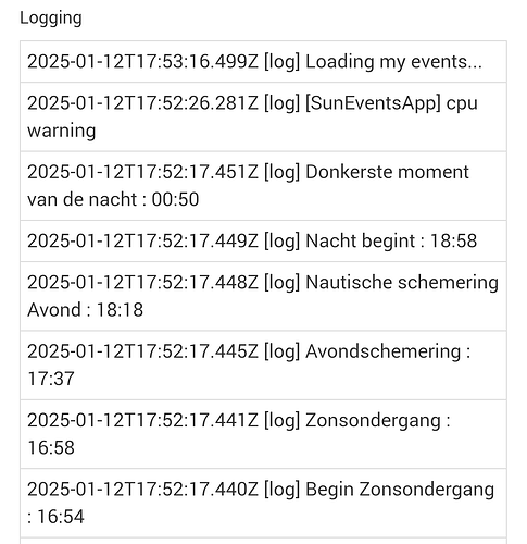

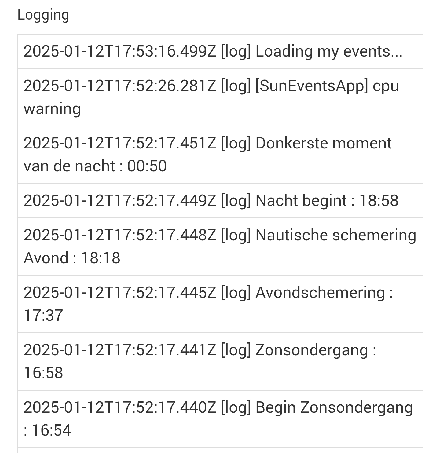

This is from the logging:
Ive just reverted to 1.4.8 and that seems to solve it for now.
Test version was always working fine.
On github this issue is reported yesterday i noticed. :slight_smile:
Yes, I also just reverted back to 1.4.8 and it seems to function properly.

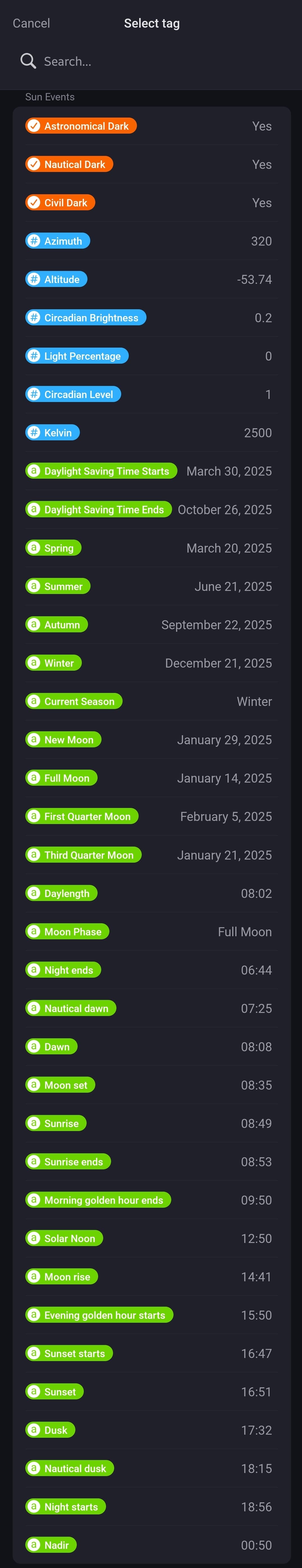

@Peter_Kawa Do you think the Solar Noon and the Nadir will work?
After all, both are shown at 12:50 PM and 12:50 AM. And that doesn’t normally exist.
In the logging, the Solar Noon does show correctly.
Edit. Translate to English.
In the tags I think it’s right, Mike,
12:50 and 0:50

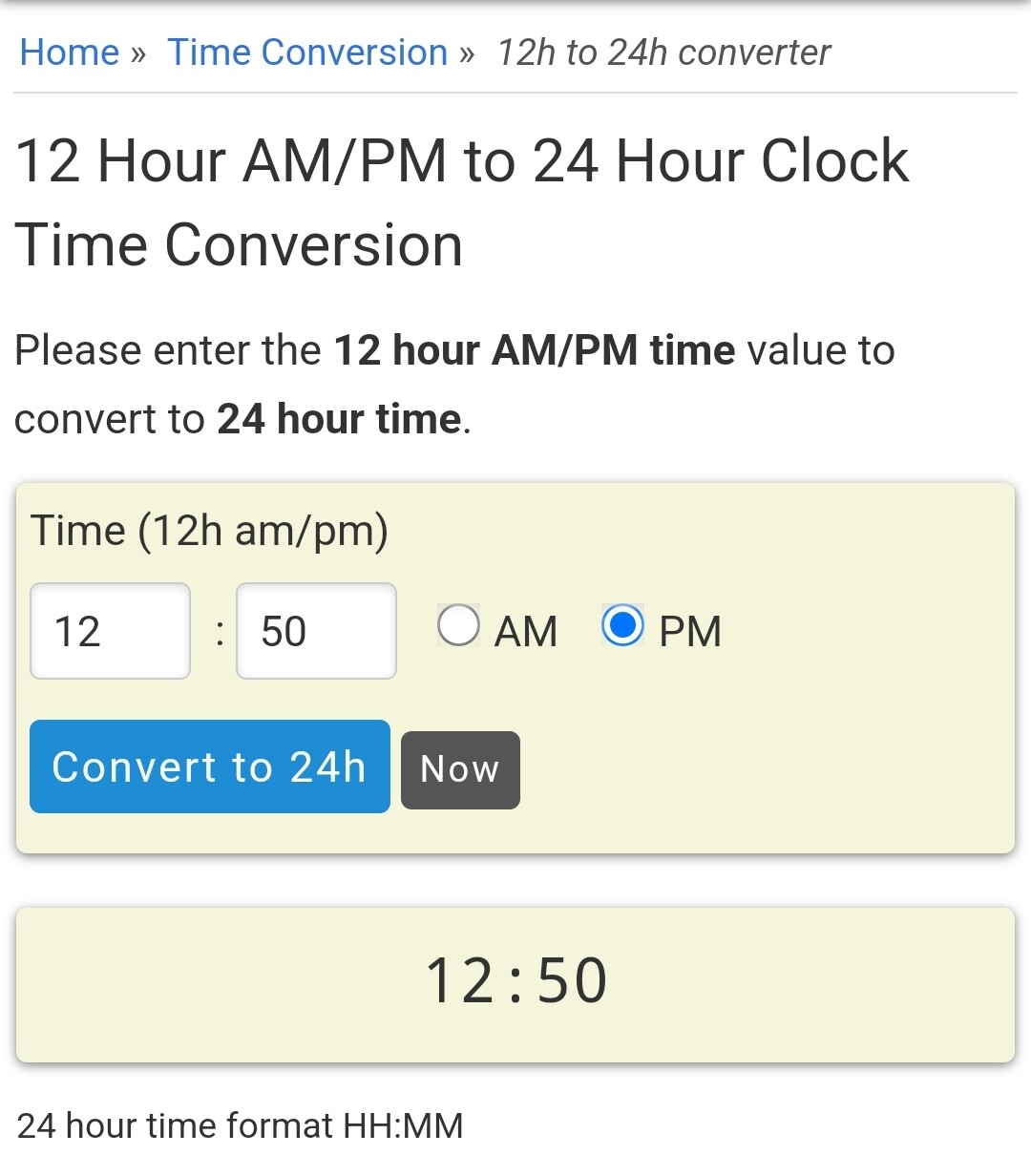

12:50 AM and 12:50 PM do seem like valid 12-hour clock times:
My Homey is set to English language, hence the mix of 12h AM/PM clock, and 24h clock times I guess.
@Peter_Kawa yes, you are right.
I was to much thinking.
