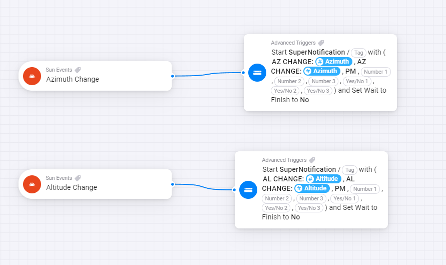

Edit1: Hold on! There IS an Azimuth and Altitude trigger card - I was mistaken!!
Gonna see how they work right away!
Holy cow, a trigger for every degree shift!!!
OK, question before I disappear into my workshop :slight_smile:
Altitude is the angle from the sunlight hitting me right? Or not? If so, going from + to - is sunset, from - to + is sunrise? What happens during the day? It climbs to what before it starts declining? The highest altitude in the day means Zenith? (In that case the change in Zenith across days, with the accompanying changing day lengths, IS the expression of seasonal change…) The lowest negative value at night is Nadir?
How do I get from Azimuth to my time (EXcluding DST)?
See? Whole bunch of questions :grin:

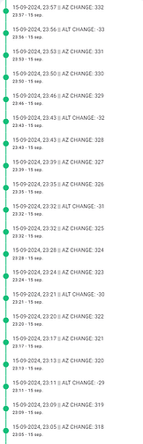

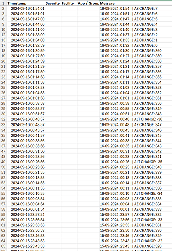

So enough theory, let’s stick to something practical: testing with Sun Events itself.
That linear interval of 4 minutes? definitely not true. Here’s what happens when I analyse Sun Events AZ trigger logging. The top is AZ progression, the middle a scatter chart of the time difference between a trigger and the previous one, using the log (Simple Log) timestamps. Something is pacing these triggers, trying to make them appear with full minute distances - but its not working. I don’t know what is happening under the hood there.
And when you zoom into the AZ progression graph you will see it looks linear - but it’s not.
Here is a longer one, you can see the sinoid wobble.
Combined with scattergraph of time between triggers: you can see a lot of (exactly!) 3 minutes and 4 minutes, but - especially in areas where the graph climbs faster - also 5 minutes.
Things just got a whole lot weirder.
Edit01:
Why are there 361 degrees of Azimuth?

  • How accurately does the Azimuth when card represent real azimuth changes? And I know that is not directly app related, but if you could please shine a light on what “real” azimuth progression is supposed to look like, that would be great!
  • This would be the question: “is azimuth progression supposed to be a progression through 360 degrees at regular even intervals”? Is there supposed to be significant difference in the time between one Azimuth ping and another? For that, have a look at this:
    The orange dots a the intervals between one ping and the next. The blue line is the azimuth value at the ping.
I hope that makes the subject more manageable - thanks a lot for any answer you may provide!
Give it a try
  • I never used a azimuth compass to compare. However, the calculated value should be very accurate as it uses the formula that is everywhere used with the most precision.
  • Yes. Azimuth is measured in degrees from 0° to 360°, starting from the north and moving clockwise. For example, east is 90°, south is 180°, and west is 270°.
    The Earth rotates 360 degrees in approximately 24 hours. Therefore, it takes about 4 minutes for the Earth to rotate 1 degree of azimuth. I am not sure how this graphic is made.
    The azimuth angle, which is the compass direction from which the sunlight is coming, varies with the seasons. For example, at the equinoxes, the Sun rises directly in the east and sets directly in the west, making the azimuth angles 90° at sunrise and 270° at sunset.
Hope this will help you a bit. Having said this, I am not an expert! At that time I started to develop the app I looked into this very closely but most of the info I already forgotten ;).
Currently, I am only maintaining this as for me personally I moved to Home Assistant.
I have used this calculation myself for many years to close the blinds when the sun hits a certain window and it worked perfectly.
@MarcelT the graph is made from taking log messages from the Azimuth change when card in the app - this is a representation of how the app shows azimuth changes. And the data seems “off” to me. Why “about” 4 minutes, and not exactly?
I appreciate your explanation though :slight_smile: It looks like I would be better off using an “every 4 minutes” timer or not, what do you think? Especially since you only maintain the app?
