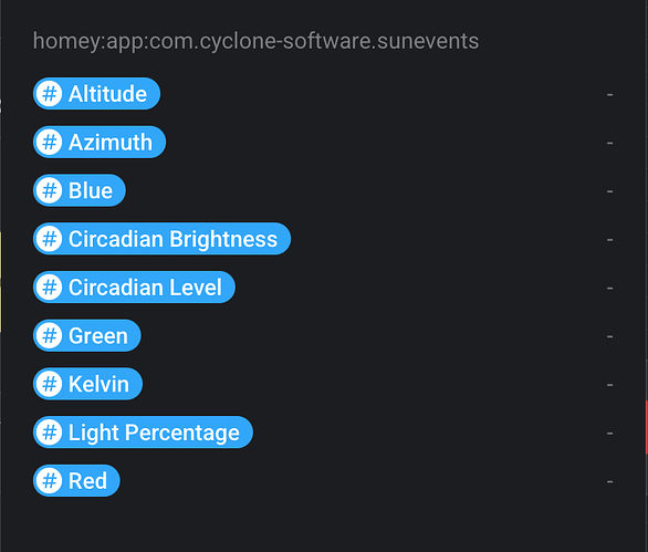

Any ide? i uninstall, reboot , install the latest verion Test, but not appear values any idea:
That’s normal for all (app) tags @ Pro 2023 and newer models.
To discover the value, add the tag to a notification card and test run it.

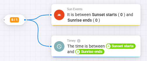

it seems that the app is not properly evaluating the condition “It is between event and event”. As you can see after sunset, but before midnight the card evaluates to “false”. I would expect to return “true” like in the condition from the app Timey.
Homey can have issues with time conditions which reach past midnight
To rule that out, I invert the condition plus the events;
With your SE card, it would change into:
and it's not between sunrise ends and sunset starts
This returns true before midnight.
Thank you for the hint that will fix my isse. :+1:

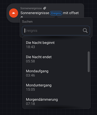

first of all thanks for this great app. But since the latest test versions 2.46 / 2.47 it’s not working anymore. All my flows using Sun Events trigger are not running any more. Could you please have a look and fix it.
Thanks.
Peter
Yes, I will look into it. The strange thing is that I only updated the localisation. Could you maybe reboot homey? As I have no problem at my Homey. Please check if this is loaded correctly:
The times with in the several events:
I have the same effect since the current update. The flows are not working anymore.
Homey is rebooted. No times in the events
No problems with the event times:
(When… Flow Card)
Using also the new test version 2.4.7.
@owuerker, are you sure that you’re using the latest test version 2.4.7? If that were the case, then the events Moonrise and Moonset would already have to be translated into German, as they are for me.
Yes I am using the latest version
Correction;-)
I had the regular Version 2.4.7. Using test version 2.4.7 I have the time for the events, too
Will check if the events are now triggered.
