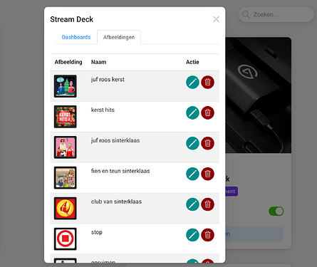

List and manage images:
Edit image:

1.0.5 20-02-2026 - Upload multiple images at once
1.0.4 20-02-2026 - Hiccup in the Homey app processing, which required a re-upload of the app
1.0.3 20-02-2026 - From app settings, Fixed the ability to upload a file after you just uploaded another file, kudos to @Adrian_Rockall for finding the bug
