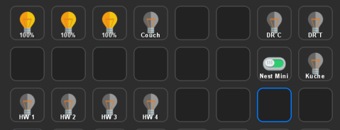

So far so good. The setup process is still a little cumbersome but the prototype is actually working rather well so far.
Looks like this at the moment:
So far it supports:
  • onOff for any device
  • Press button (only primary button capability)
  • Shows dim percentage for turned on lights
I would be interrested in what kind of usecases people would possible have for their streamdeck?

Rough preview:
very valuable would be to know what kind of features you would want to control or visualize. Because this feels like reimplementing Homey :smiley:
