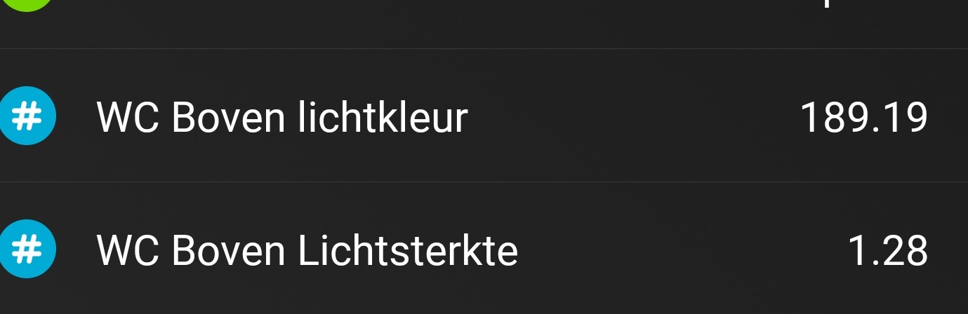

Then when the value should rise to the maximum value, the actual value written to the logic is higher then the maximum value. I have noticed this with both Homey Logic and Better Logic, although the Homey Logic is slightly less going over the max value, currently 1.09 where I have seen 1.45 at Better Logic. As this value represents a percentage, the flow using the logic can’t handle that value.

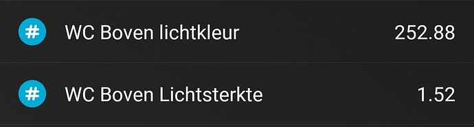

I just checked again, the value of the logic has now increased to 1.52.
Which would translate to 152% while the flow that actualy uses that value expects a maximum value of 100%.

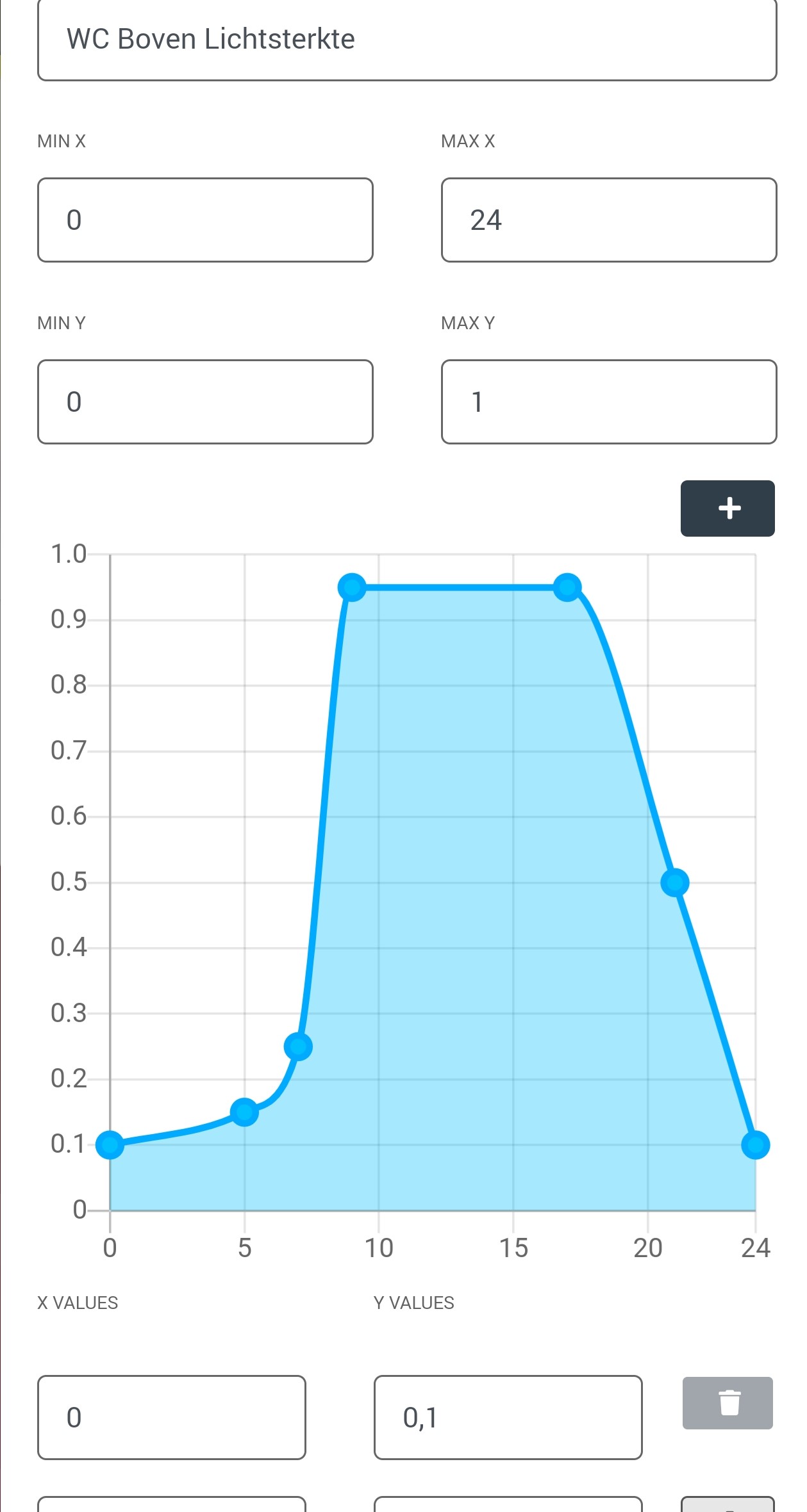

I have capped the maximum value in the spline values itself to 0,95 (95%) But it still goes over the max set value, and it increases a little with every query.

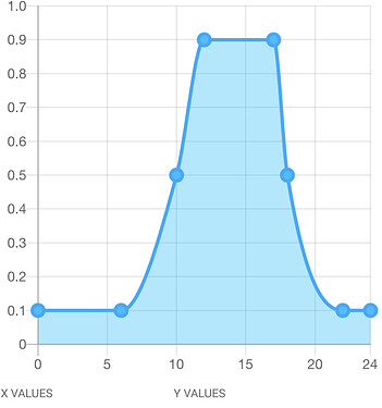

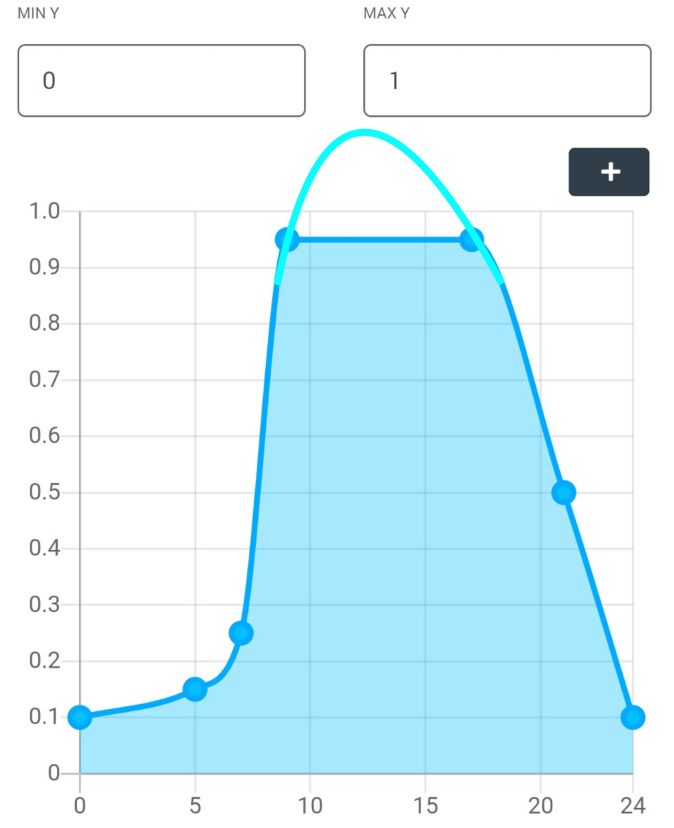

The graph is still showing a flat line at the top. What I think may be happening is that the spline is interpreted like this:
That is quite an interesting theory, I will see if the value decreases after 14:00 today.
If not i will add some data points and set a different value between 9:00 and 17:00 for every hour. So tomorrow I shouls see something from that.

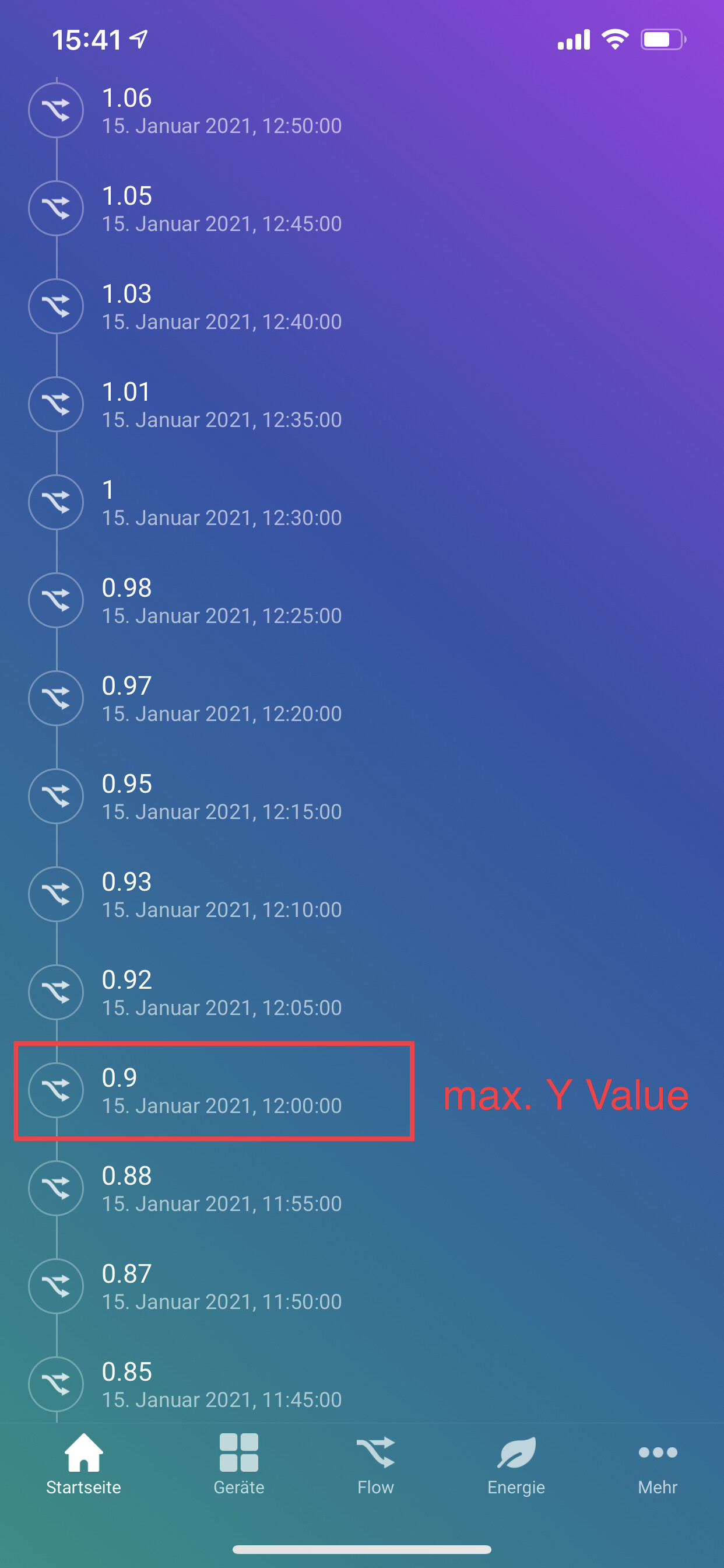

@Twan_Veugelers, I can reproduce the issue.
What I don’t understand is why you get a different value with Better Logic than with the Build-In logic?
The suggestion made by @robertklep is absolutely correct, I see a decrease of the values after the top of invisible arc has passed. So the app continues to calculate the arc, although it show cap it at the max value.

I would personally think that the line shown in the graph is what determines the output values.
But then it becomes almost incalculable and causes errors. A dimming level above 1 will cause an error, probably.
