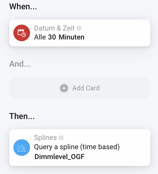

I query every 15 minutes
If I understand correctly, that should not matter, from everything I read, time based should be 24 (hours). And then the query will start when ever you need it, which is the whole intention of the Splines app anyway. I do use the timebased query card. The 24 value is only to show the number of hours, it could also be set to 1440 and using the time based query, it should move one X value every minute. So it will be a question of preference, and knowing the if you want to set a value at 13:15 it would translate to 13.25 in a X=24 Spline.

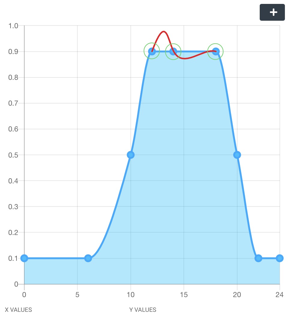

This is the shortest query interval you can get with a time-based flow (query every minute). But you have to distinguish between the self-defined query interval (every x minutes) and the calculation of the splines in the background.
Back to the query intervall and how to prevent values above 1.
How should I explain it understandably?
The problem is that the values are interpolated between 2 points (X/Y value). This is the reason why you get values greater than 1 (see Robert’s curve).
If you set additional X/Y points in the upper part of the curve at the interval of the query, then it doesn’t matter if the interpolated curve goes beyond 1.
I have tried to show this in the graphic. To make it easier to see I used a query interval of 2 hours. I hope this is understandable.
Note: Everything I have written here is based on assumptions. Therefore it would be helpful if @MadMonkey could make clear statements.

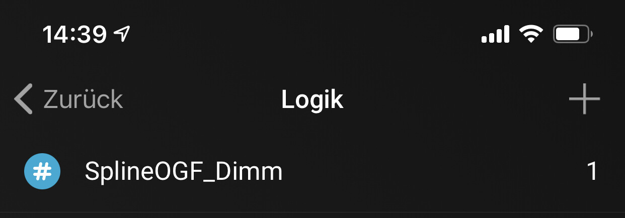

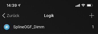

The calculation still seems to be incorrect. Or the flows are incorrect.
At about 14:40 the calculated value is 1 (see screenshot of the variable “SplineOGF_Dimm”). According to the curve, however, the value should be about 0.94.
The UI is interpolated and has some tension that might not make it absolutely even. Just add another node if you really need exactly this value there
Okay no problem.
Just to be sure, the calculated Y value won’t be greater than 1?
