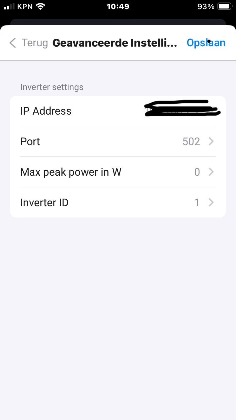

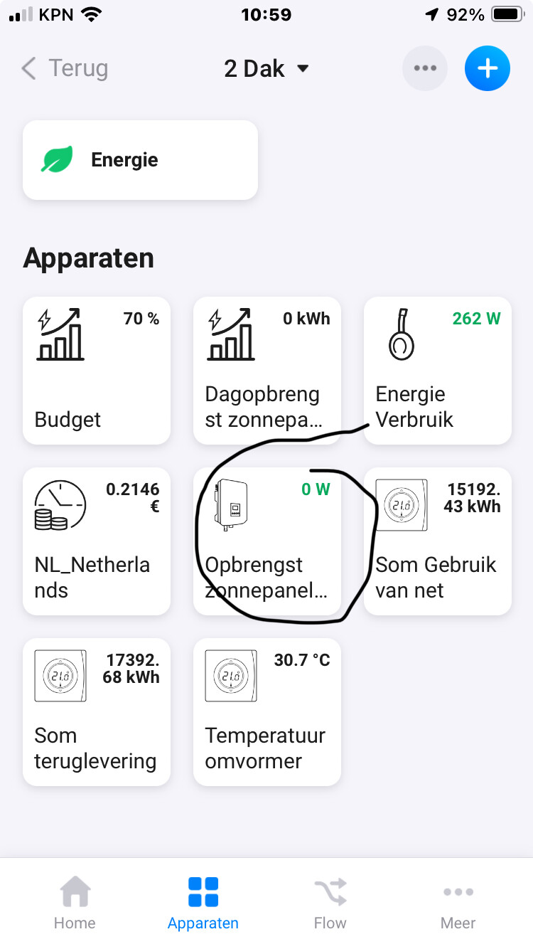

I had to restart my router due to problems with KPN router.
Some devices did not came “back” in Homey. Restarting apps worked for most but I had to restart Homey as well. All apps are back again onlly my SolarEdge is not giving any values.

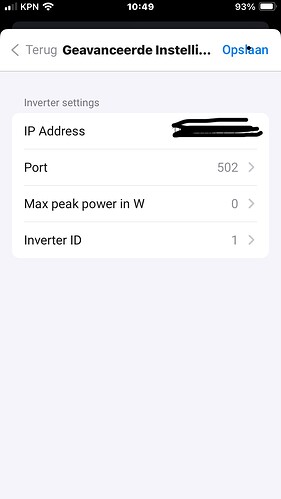

I see there is a maximum watt in settings
Are my settings correct?
Are you sure the IP address is correct? Don’t share this but check the IP address of the inverter and set this in the app settings.
You wrote KPN router, which is normally set to DHCP. The old IP addresses given are for sure different from the ones after the reboot.
IP was the problem. Tnx. I did not thought about that :fearful:
Thanks for reporting back. Have fun!

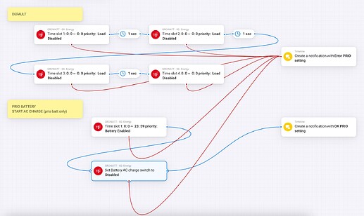

The settings for PRIO MODE settings in the app are recently implemented (at least for my inverter) I Did some testing during the process of development. Note that it is crucial to SET all time slots different, no overlap is possible when enabled, see my test grid below.
Also note that the inverter needs time, I had to build-in 10 minutes of delay between some prio settings.
