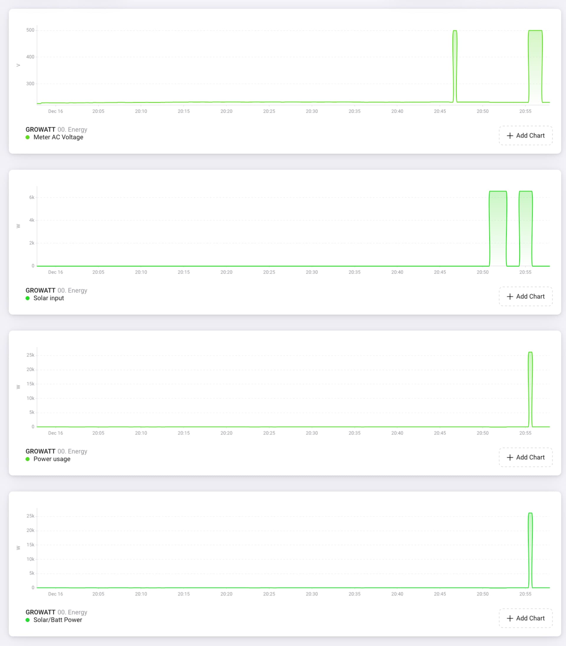

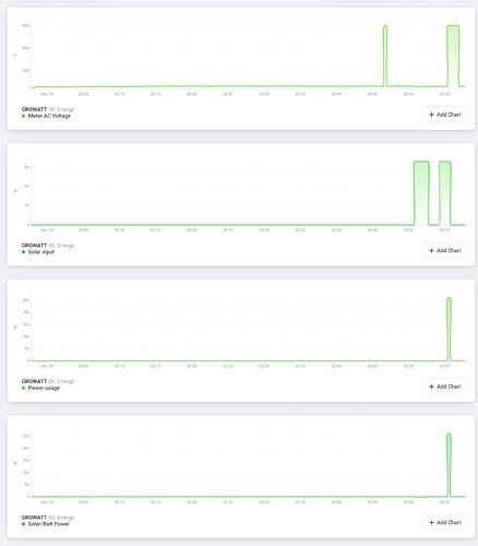

Just occured a peak of which i was able to narrow to the hour layout. See for yourself:
yep super weird. at 9pm there is no sun for sure.
yep, and more than 25kW power usage… The inverter has some chinese wacko moments. Pretty irritating since the insights average calculations are useless.

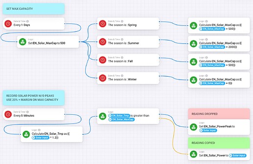

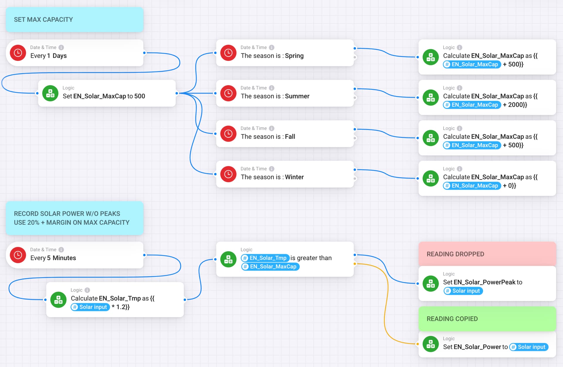

[EDIT2] A solution to the problem is to use a variable and simply snapshot each 5 minutes the solar power value. If the actual value is >100% compared to the average of the 30min before, allows you to disregard that value and store the previous value. Keeping the average of the variable flat.
This only works if the system is technically not able to have a difference in solar power within 5 minutes of 100%…
All of this has no effect on the occurrences within insights, the problem persists.
Just created a flow that will record only the correct solar power data, interval 5 minutes.
The margin is 20% above the calculated max capacity, depending on the season.
The flow will record the peaks as well in a separate variable.
Simply use both variables in insights and 4get the solar power original.
It does not solve the root cause…

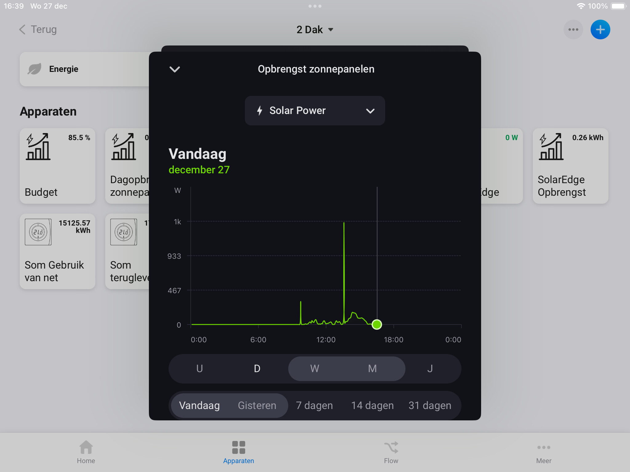

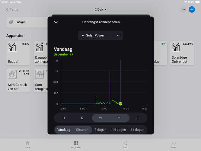

insight today with this app:
And values in Power by the Hour:

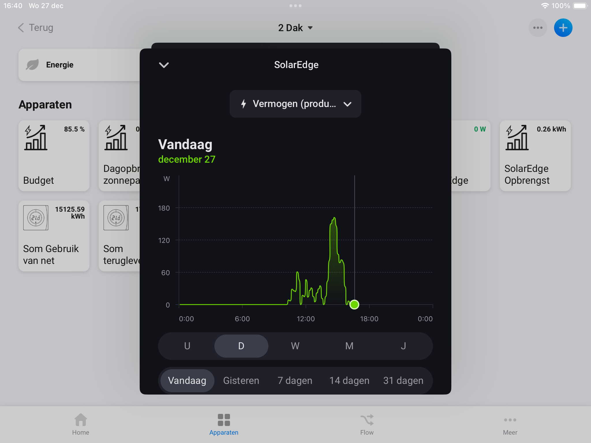

Insight today with “Zonnepanelen” app:
And values in Power by the hour:
There is no spike. (Same SolarEdge inverter)

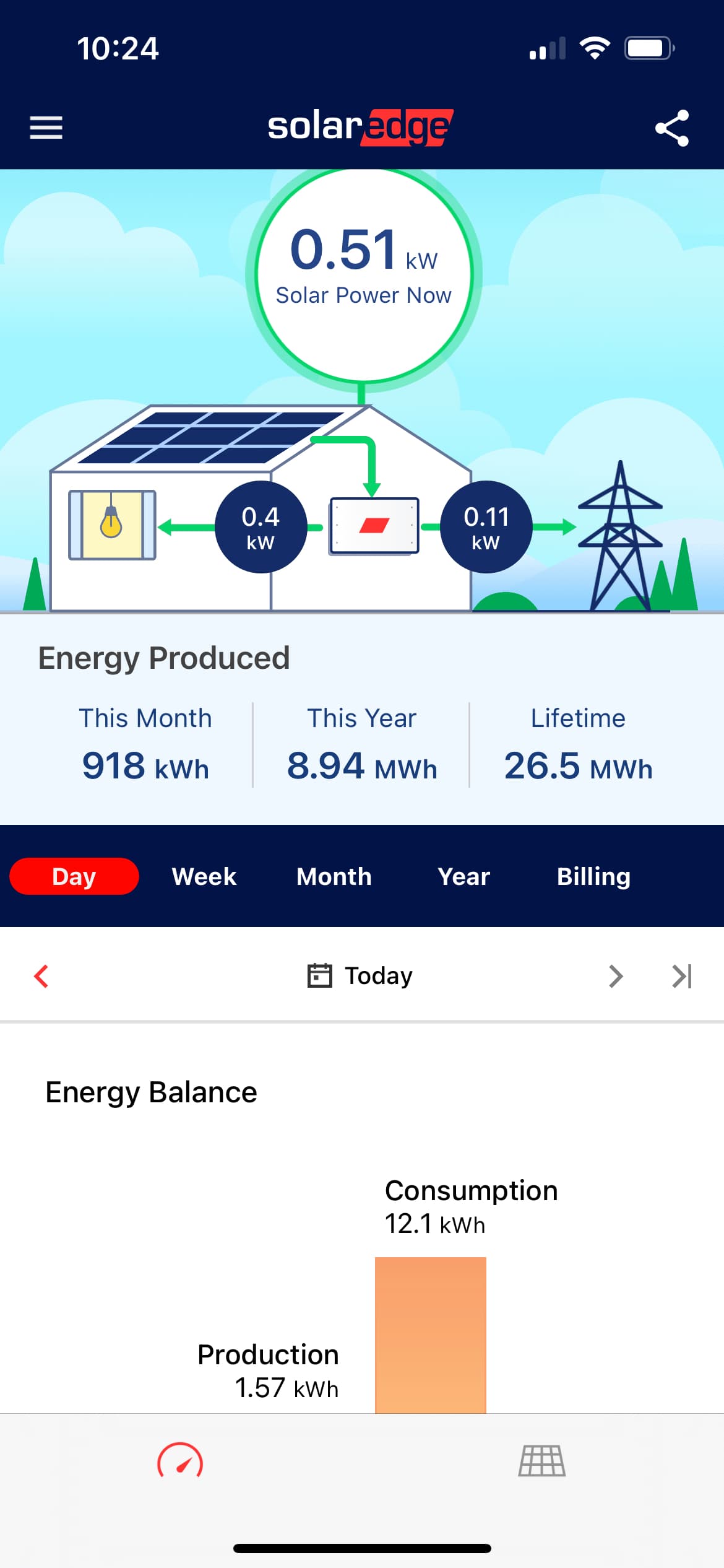

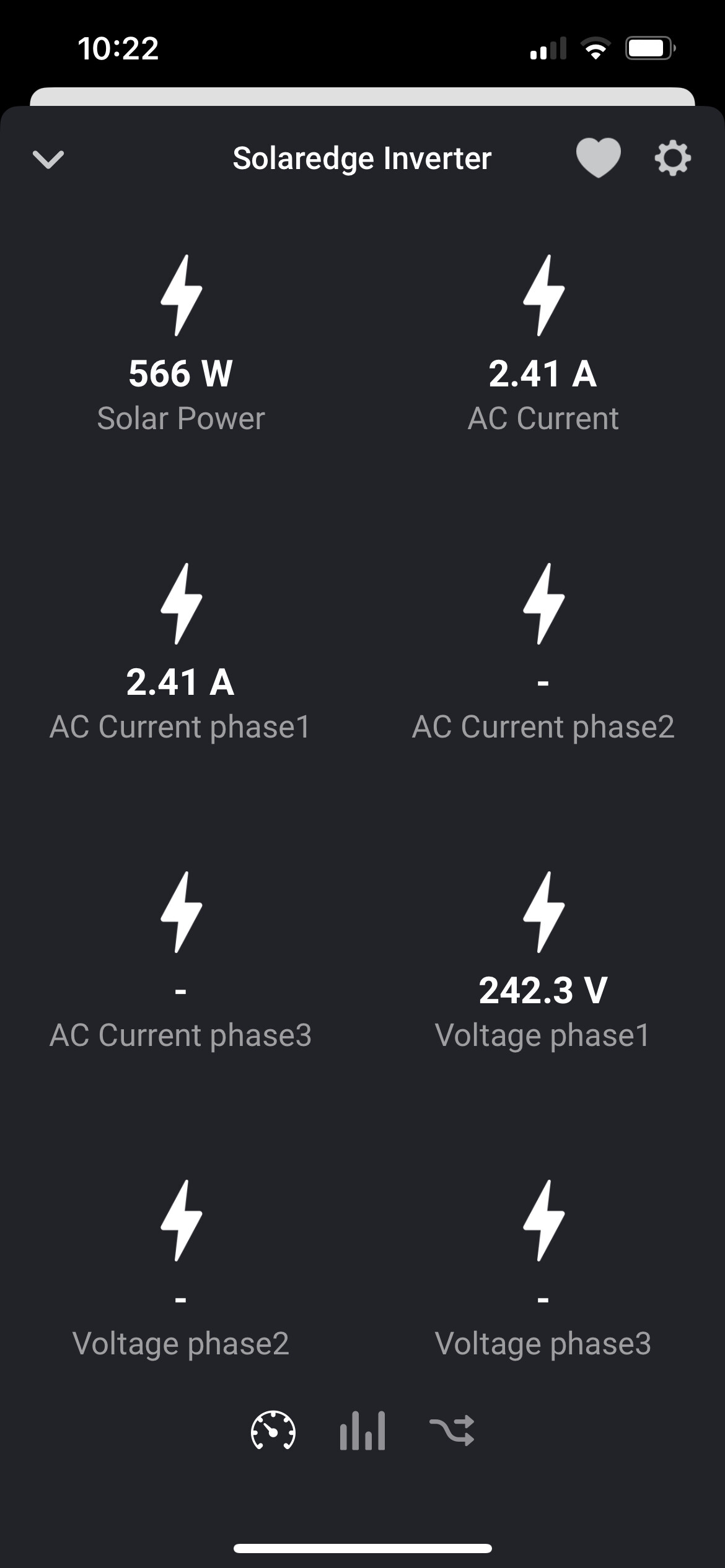

With the app in my Homey Pro - it only shows solar production and not consumption data. I’m not sure why? The consumption data is there on the my solaredge app.
Here are the screenshots from the app and my solaredge
