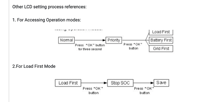

Here is the info when selecting the load 1st modus;
There is something mentioned as ‘The Load Priority Prohibition Mode’ …
I try to understand what this tells us.

Guidance for Operation Modes of the SPH Series Inverter
was also thinking about batt 1st, set to 100% (don’t reach 100% ) and disable AC charge. .
The battery first modus has no DIScharge stop SOC, only Charge Stopped Soc.
The only remainder is grid first, but no problem with that modus at all.
have this link bookmarked since it explains the mode variants with pictures… easier for me…
When the solar is sufficient, solar will charge the battery at top priority, and the surplus solar power will support the loads with the grid.
When the solar is insufficient, the solar will charge the battery at top priority, while the load will be powered by the grid. If you enable the AC Charge function, the grid will not only support the load but also charge the battery together with solar power until battery reaches “Charge Stopped SOC”
