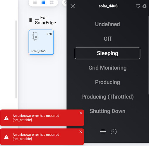

But In the Web interface I see another issue.
cool,
yes invertor status is not setable solaredge.modbus/invertorstatus.json at main · biemond/solaredge.modbus · GitHub
then homey is doing this. yes let me look at this again, maybe I should make it a string field and not use a picker.
thanks for the feedback, publish a new version
Thanks, looks good.
