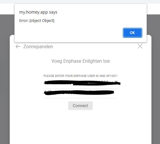

Does anyone have any suggestions for the Enphase Enlighten now that the end of life for Enphase API v2 is approaching (Oct 31, 2022) and we’ll have to move to API v4? ( https://developer-v4.enphase.com/ )
It was working fine with v2, but I can’t get it to work with v4. I have an API key, a user Id and I have authorized things i.e. the new API is showing in my Enlighten dashboard - just like is working fine for v2 - but no go on v4. Thanks in advance!

Thus far Enphase API v2 is still working, unknown for how much longer - it would be nice to get some insights on the use of the v4 API. Is the app developer aware?
See Enlighten API
But check the plan, the free plans is ratelimited on ammount of API Calls ( * 10 hits per minute
  • 1,000 hits per month), others plans you need to pay a lot of money…
I’ve checked that, but can you point me in the right direction how that links to getting it working on Homey using the Solar Panels app?
The free plan is sufficient (for me)
Thats not so simple as sending a http request, you need first authenticatie with you enpase credentials (by Oauth2 Oauth 2.0 Explained in Simple Words, Basic Understanding ) before you can make a request.
So if a developer create an app for the enphase V4 API ( it is possible , it’s just like mine Daikin ONECTA app) then alll users can do 10 calls a minute and 1000 calls a month.
A simple calculation is : if we do every 10 sec a call(you want your solarpanel metering near realtime).
thats 6 calls a minute , thats 360 calls per hour (6x60).
With a limit of 1000 calls per monits , your readings will stop after 3,5 - 4 hours for the rest of the month.
Basicly this is free plan useless, and to make an app special for you seems like a bit of overkill.
Extra note : with 1000 call a month you can basicly do a call every 1 hour (24h x 31 days = 744 calls)
Also its not very clear in the API documentation if this amount of calls is per user or per ipadress

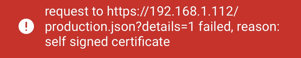

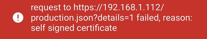

Hi All, trying to add Enphase Envoy S to homey, but I always get the same result…
Does someone know what I might be forgetting ?
Eric
Is it possible to enter http without the s?
Then you don’t need a certificate.
The only thing I can fill in are my Enphase account credentials….
If I copy/paste the url in a browser, I get redirected to a page where I have to fill in a token.
There is also a link there to create the token.
After entering the token I am logged into my Enphase account. So it seems I need to enter this token somewhere inside the homey-app, but no clue where to do this…
