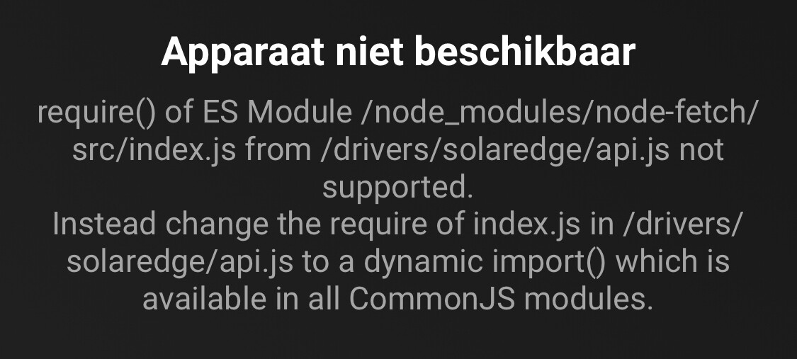

Since the update, SolarEdge no longer works for me. Get the following error.
Or is it a fault on Solar Edge side and do I have to wait a while :slight_smile:
@Sjoerd1 Hey! That’s a fault in the update. Should be fixed after updating to 5.1.1.

Thnx for the fast respons @Diederik. Works again! :smiley:
