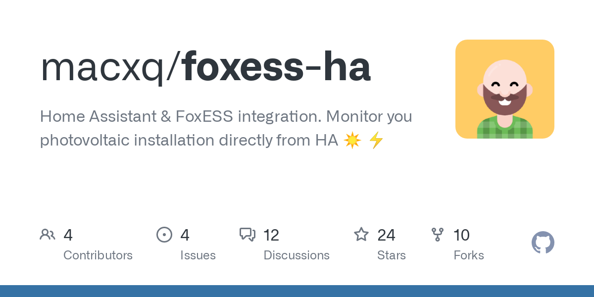

Heya!
Is this something that could be added to the app? Going to receive a Fox-ess inverter in a month or 2 so would be awesome :grin:
FYI (and I created an issue @ git)

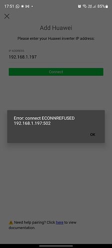

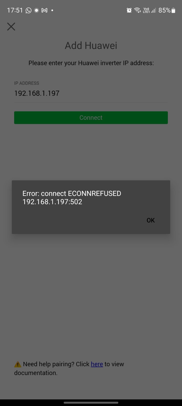

I have model: HUAWEI SUN2000-10KTL-M1 and I have the problem mentioned already, I cannot add it via IP address and I get this error message. I have read the instructions in the app and they are met.
