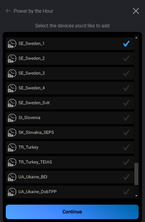

  1. Add a PBTH day-ahead pricing (1 hour spot prices) as Homey device, and select your market from the presented list. For Sweden (I believe you are Swedish :)) you can select from a number of market options:
To find the one you need you can ask your energy supplier, or check this site and find a match with the pricing you receive from your provider: Data view

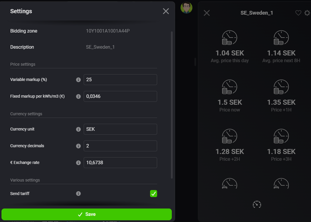

2b) Add the taxes and markups to the market pricing. For this go to the advanced device settings:
In above example I set 25% sales tax, and 0,0346 euro fixed tax. But I am sure you need to add more fixed markup, e.g. the markup your energy supplier is adding. Important: all fixed markups must be entered in Euro!
2b) Change the currency and exchange rate.
In the above example I set the currency to SEK, and the exchange rate from EUR to 10,6738.
2c) activate sending the active tariff to your solar panel summarizer (see checkmark)
