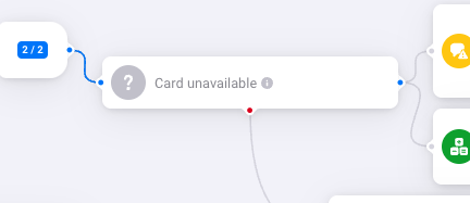

OK, I have downloaded 3.2.2 and this happens. Card Unavailable. Error - "Network Request Failed. And if I try and replace it Solcast isn’t in the Apps list. Happened with 3.2.1 also. Because it crashed I couldn’t generate a diagnostic. Here is one after the App recovered.
Screenshot 2024-04-10 at 10.44.19 AM
Screenshot 2024-04-10 at 10.44.42 AM
