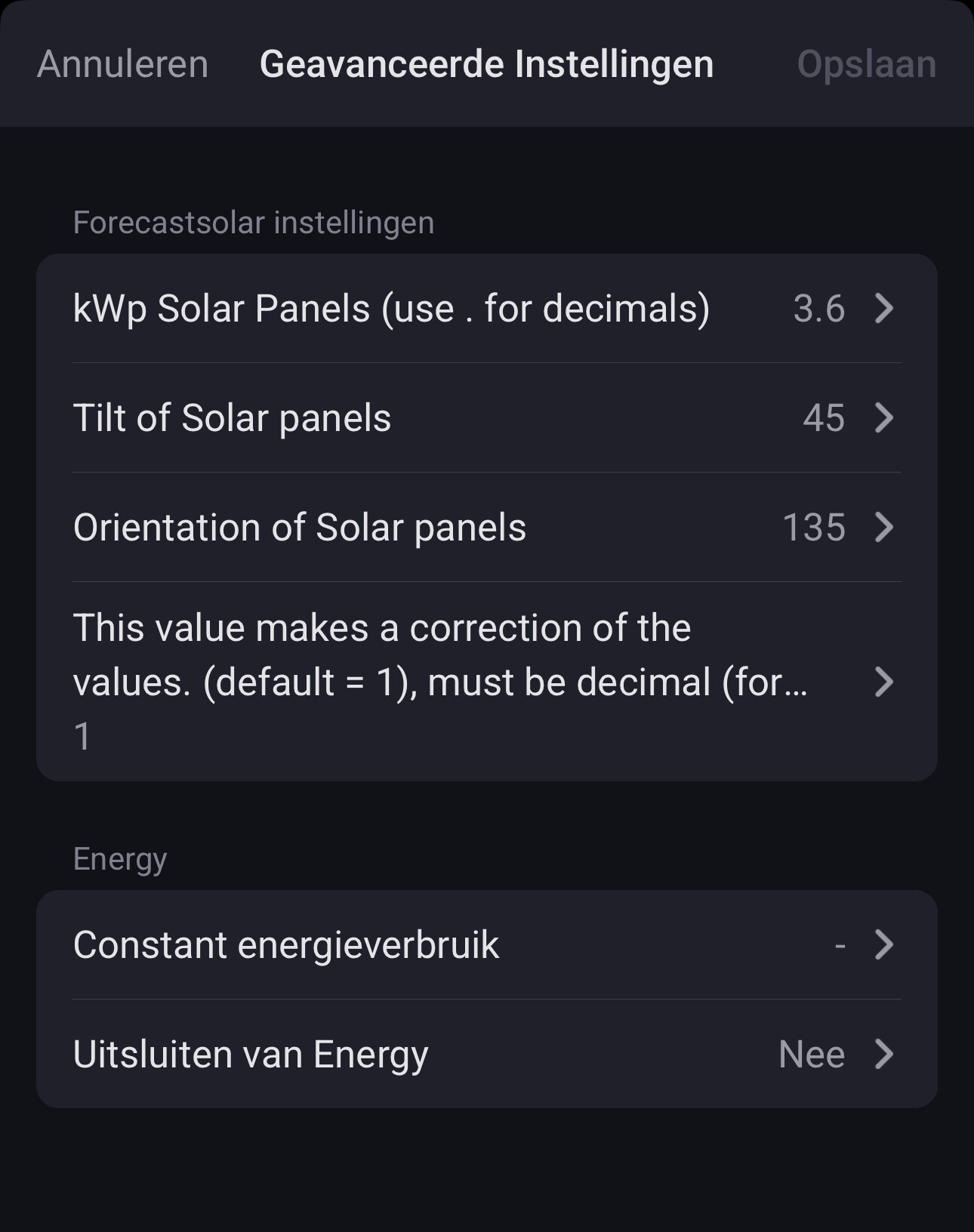

I just got my HW plugin battery in and started playing around. I stumbled on your app for forecasting solar production (Thx Johan). What a bit is confusing is the two devices one with API and the one without.
The issue is with azimuth where my panels are on the portal South East -135 but when I apply the same to the non API one it seems it needs a positive 135. As I tried the negative value which did not update the parameters. Or was this just a glitch and should it be negative too for South East?
It are 2 different services. No need to use both.
I prefer N= 000 and South = 180, so that is why forecast.solar is like that. (European service)
The Australians of Solcast have a different approach, this is not something I can change, it is more confusing indeed.
Ok, just figured 135 only gives proper data (graph loads and no strange dates below the graph).
Yet the API one gives a better forecast looking at today’s weather and what the panels did today.
