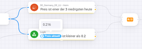

Unfortunately, it’s not working properly yet. I just created a test flow. Remaining today = 2.84. kWh_PV_Required = 7.526. So both conditions are true. However, as you can see, the card with the cutoff time is false. Solcast reports production until 19:30 today. So the cutoff time card would be less than expected today. I’m happy with the AND card. Because I can use the same function again in my flow to improve forced charging. But at the moment, it’s not working as expected.
So obviously the upper condition is false according to your screen shot (yellow bar and yellow point at the false branche).
You can check the value by moving the mouse over the value as long as the flow is in test mode.
Example
So check the test outcome again. Probably you find the error, or you can provide more details.
For the moment I think it is not correct and I have no idea on fixing it.
Indeed, but it should be true.
