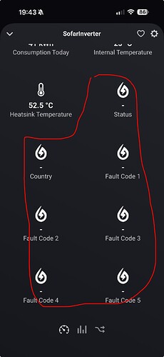

After a few days of testing, I only have one for the missing registers that we can still try.
Register 500 for the status of the inverter.
I don’t think all the other values exist.
Unfortunately, I still have the problem that sometimes the devices are not reachable.
With the battery it looks like this:
The other devices then only display incorrect values.
It would be great if we could fix that.
