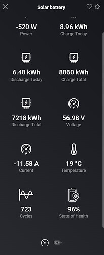

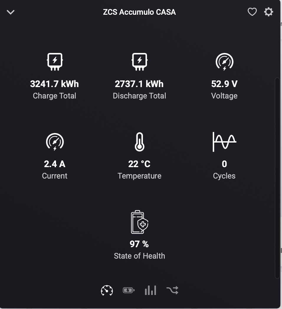

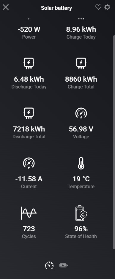

It should appear in the Battery device along with the other information. As it’s added on the fly when the data is detected, it will probably be the last item on the page.
The SOH does not appear in the battery, there are the same parameters as always.
Furthermore, in the latest beta I noticed (I don’t know if it’s a coincidence) that I have peaks in values that are completely out of scale (perhaps due to wifi?) and I was asking if anything could be done about it.
Hmm, I think I have found some issue in the map file where the name fields have spaces instead of underscores. I’m not sure if that is why it’s not putting in the SOH, but explains why you don’t see a battery voltage.
Interestingly though, after some research I found the SOH register for my inverter, so I have added it to my map and I can now see the SOH in the battery device.
I will fix the map issues and post a new test version soon.
