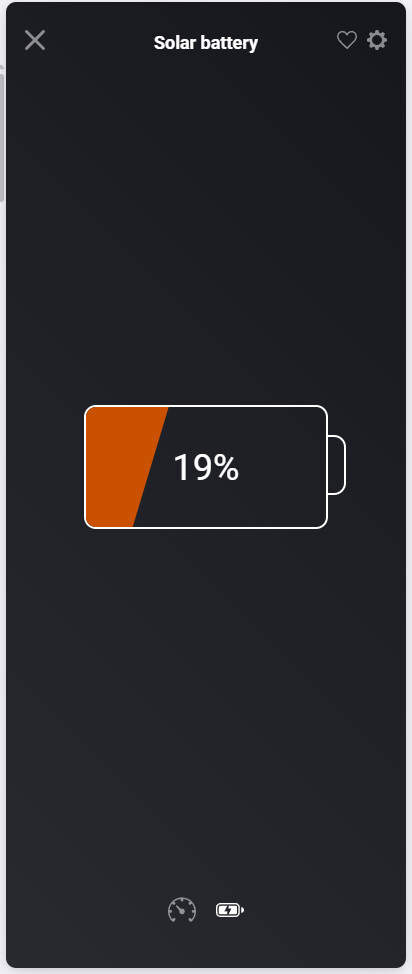

That should already be in the Battery device:
Sorry, maybe I didn’t explain myself well. I didn’t mean the charge percentage but the battery’s state of health percentage. “SOH” (State of Health) and “storage” refer to a battery’s State of Health, a measure of its current capacity compared to its original capacity, often expressed as a percentage.
I have published a new test version that should add the SOH if the data is provided.
I can’t test it fully as my inverter doesn’t have that information.
in the sofar log the SOH is present but I can’t find it in the written properties anywhere.
exactly where should this data appear ?
thanks
