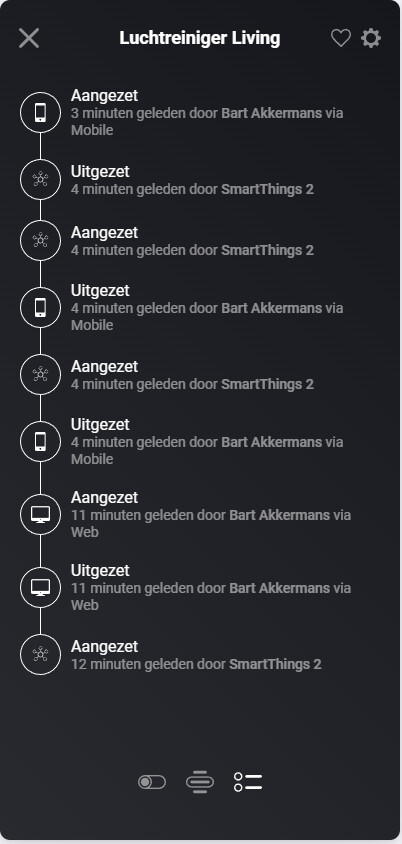

just to notify in the device log it notify when device is turn on or off but not when mode is changed.
That is normal as those insights only log Boolean capabilities, so nothing I can do about that.
