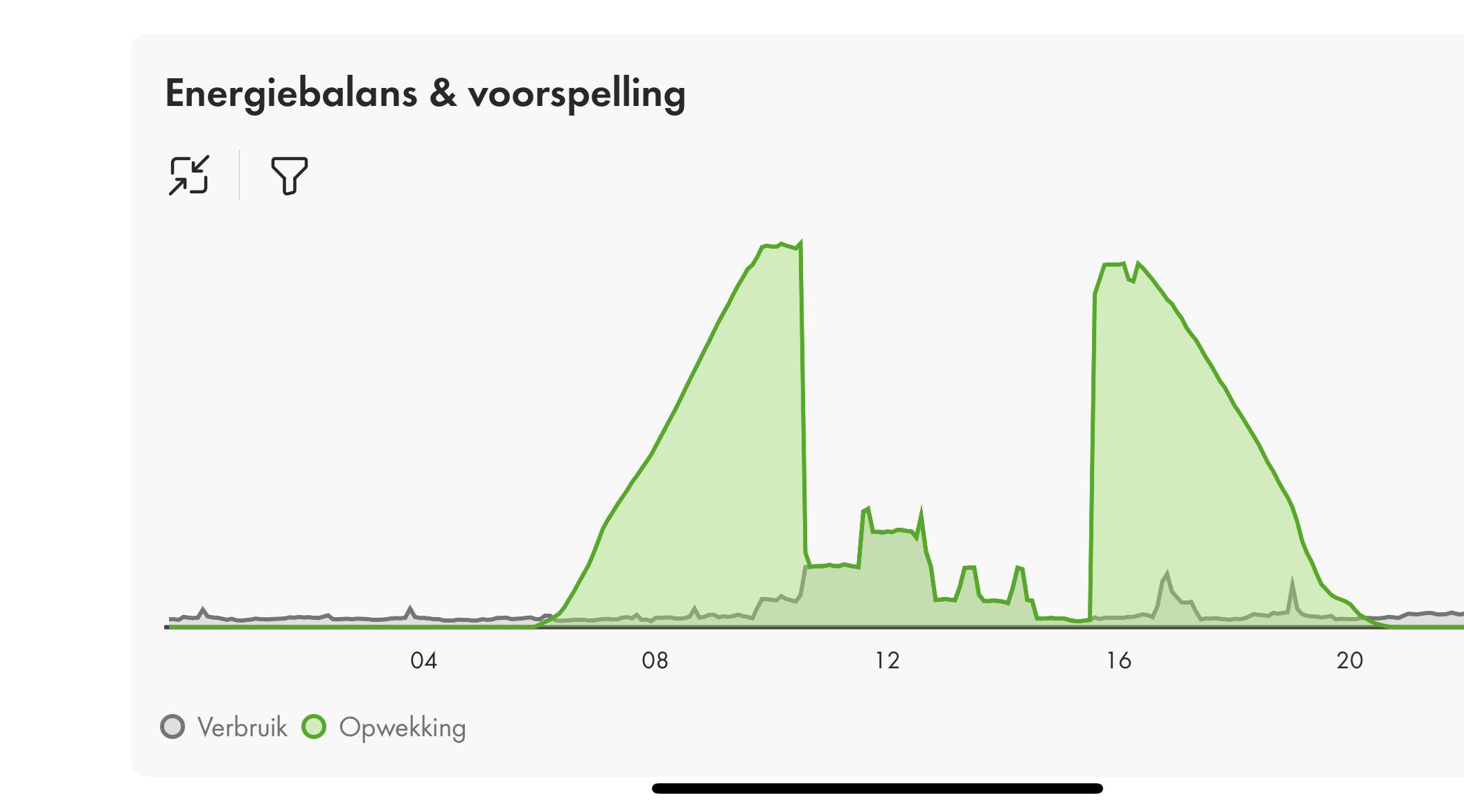

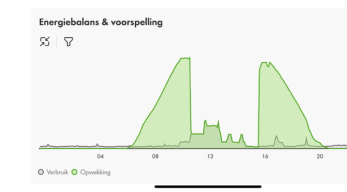

I was using the set output power last Sunday to mitigate negative electricity pricing. But after a few minutes, my Inverter is stuck at 404W. I cannot reset back to max value or change to any other value from the Homey app.
If I logon to the inverter as installer, the grid export value is at max. If I try to change the value to something else, it saves OK. But the value is still max.
In the eventlog of the inverter, i have a ton of error like this “10120 currently permitted number of parameterizations exceeded”.

I guess you need to graph your energy use to know what your consumption pattern is. In my case this is an example from today:
Orange is sun.
Yellow is battery (managed by Tibber)
Blue is house consumption.
Purple is import/export at the grid point.
So if today I had max sun and charged the car on excess solar. Blue and Orange would follow and Purple would be flat at 0.
If it would be a case of negative pricing, Orange would follow the Blue line and Purple would be flat at 0.
As you can see, setting a 400W flat solar production for 1 hour would not really do much.

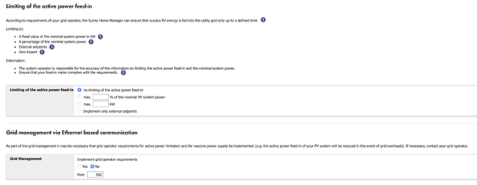

I found a way to limit export power to zero feed in.
If you have a homemanager 2.0 you can write 0 to register 40016.
0 means zero export, always taking self consumption in account.
After one hour it falls automatically back to 100 procent.
So you only have to write it two times in the hour.
Interesting, what settings do you have on your HM2? Thinking of these. If I only write to 40016, nothing happens for me, so I guess some settings need adjustment.
EDIT: Manually setting a max export in sunny portal works.
Do you write to registry 40016 on the inverter or on the HM2?
EDIT2: Writing it to the HM2 after enabling the grid management to Yes; then it works for me. Limiting of active power also needs to be enabled I guess, didn’t try without it enabled.

EDIT: yes you have to enable grid management
