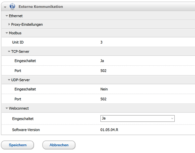

I’ve had the problem for 3–4 days now that my inverter no longer displays any values. I’ve had this issue before. Back then, I simply “reinstalled” the device in Homey. Unfortunately, this time it didn’t work. As soon as I search for the inverter in my network, either automatically or with a reserved IP address, it doesn’t find it.
Via Sunny Explorer, the settings are still correct.
Do you have any idea?
Try this, disable and enable the Modbus service @ your inverter
The solution worked, but unfortunately only for three days. After that, I had to repeat the whole process. Does anyone have a permanent fix?

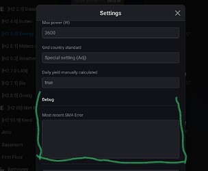

Any error messages present at the “Debug” field?

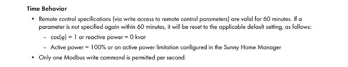

Usage of the set export limit action
To only produce solar power for your usage and not export any power, invoke the action with the value 0. To reset the value back to its original setting, set it to 100. The unit is in %.
So, I’ve already an active limitation on my system because the PV production is higher than the grid connection. So, If I put in 100%, what is 100%?
Is that, my currently set grid limitation setting OR the maximum available PV production?
This are two different things.
I set the limitation to 1% and back to 100%.
My plant automatically keeps the limitation at 71%, (I have also grid limitation)
No there is no debug message present
