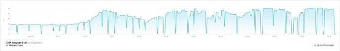

Reading my inverter, I get a lot of zero’s in between correct data. Is there anything I can do about this?
Do you connect your SMA inverter via wifi or cable? I don’t observe that on my inverter (I connect via cable). Could this be network related?
Hi Richard,
Thanks for checking. While the inverter is connected via ethernet, Homey only uses stupid 2.4 GHz WiFi… I relocated Homey, and the problem seems to be solved. I guess this problem also caused my other inverter’s connection to fail. Come on new Homey Pro with ethernet…
