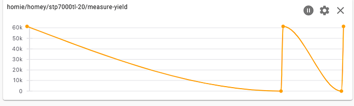

  • I do see some issues with the inverter “Lifetime Yield” (or also known as “total yield”) in my case. I do have some older inverters and I do see periodically 0 values. This causes issues in my case because I’m transferring the values via MQTT to Home Assistant and there I have a graph which does an increasing of the value. However if I get 0 values HA get’s confused as short later it goes back to the official value, so the increase is huge. Do you see any possible optimisation on your side? I’m guessing this is an issue of my inverters, however it’s quite annoying for me. Screenshot below. Btw. this happens only for my inverters and the
Btw. really a great app which is a huge benefit for me and the whole homey ecosystem. Thanks a lot!
Edit: I’ve just seen that the “'0” issue for the inverters happens not only for the “Lifetime Yield”. It seems that it happens from time to time for all keys. It’s just not that easy to see as the most values are anyway 0 if the inverters are offline (which they are at the moment). However the Sunny Homey Manager 2 works like a charm, no outages there.
:+1:
Regarding the 0 value for lifetime energy, I added a simple check if the reading gives 0 then ignore it. There is a new test version available that will go live once approved.
Thanks a lot for this fast change :-)!
