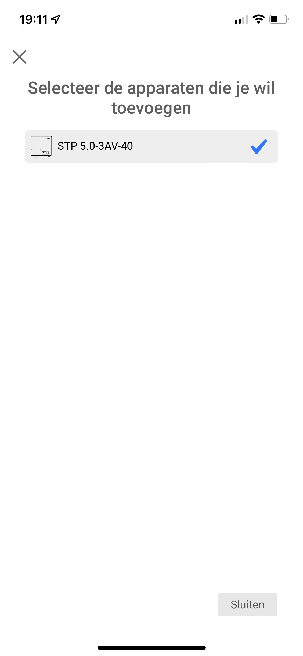

I got this error message, then it flashed into a new screen displaying the inverter, then when I pressed “sluiten” it did not add the inverter.
1:
2:

Version 2.3.6 is out, should solve the problem related to adding a new inverter. I introduced this problem in version 2.3.5 it seems.
Thanks for the effort Richard!
I have update the app to 2.3.6 and I do notice a change, but I’m still not able to add an inverter.
Step 1 says “trying to connect” now, which makes more sense. The close (sluiten) buttton works now, it didn’t before. But there is no add button still

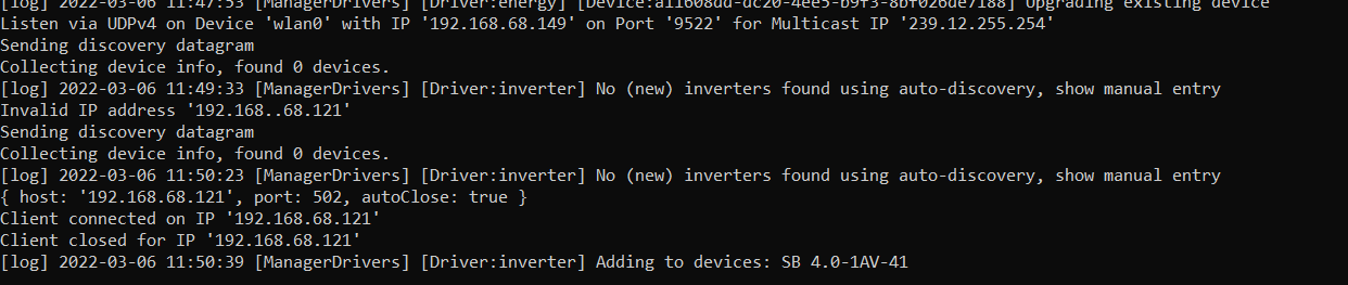

Please use command homey app run, then you will see output from the app in the console window and we will see what is going on.
@Richard_B
looks like the same as app. the “adding” button is missing
I didn’t expect a different outcome, only wanted access to logs - which I got and that is very helpful.
Seems like Athom changed the functionality of the pairing process at some point so the app can’t visit the same view more than once. Had to add a new artificial view (loading), but it seems to solve the problem. Auto-discovery always worked, only when the app did auto-discovery and didn’t find any inverters and then showed manual entry that it didn’t work.
