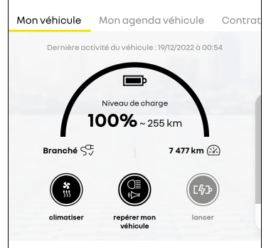

Another little problem with the battery.
My car has a 60kw battery and it is charged at 100%, yet it displays 48kw, and 82% charge.
Why ?
In addition, the battery temperature still displays 20°c while it is -4°, I am surprised.
@Matthieu_Moreau
The temperature is always 20c in the Renault API so this I cannot fix.
I see in the old diagnostics from you that there are different numbers on the charge percentage etc. but could you send me a new report and also note the values you see in the display at that time?
/Jonathan
I sent it to you in PM

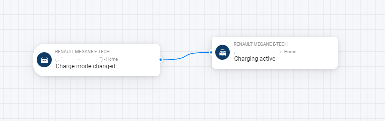

Hi @Jonathan_Cohen
Is it possible to get a trigger for plugged_in state?
/Rikard
@janrikard
@Matthieu_Moreau
Not charge mode, if its plugged in or not
A trigger so i can se if this changes
/Rikard
@janrikard
does the Vehicle at home change when i plugg in and out the cord?
No I don’t think so, but what is the final goal?
I need to know when my renault is at home and plugged in and I need to be able to know when the plugged_in status changes.

I have added a new version to test
This have triggers for plugged in and charging status.
Note, also changed how is home trigger card works, so it follows Homey standard for Boolean values.

It seems to work just like it should
now i kan easily se if the car is home and plugged in on my smpl-display so i dont miss charging the car at night
/Rikard
