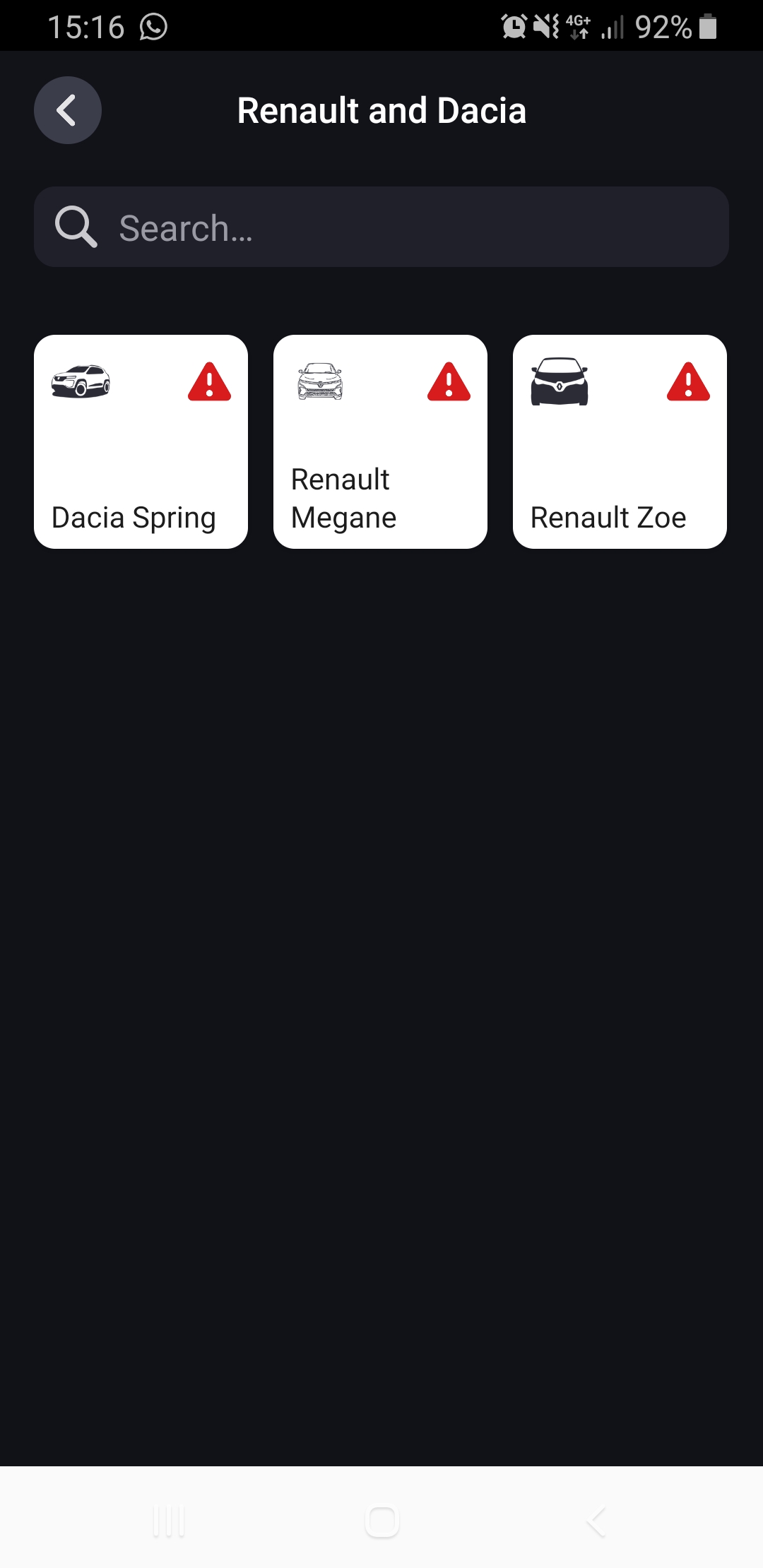

I only get this when I’m opening the one Zoe tile. Not when opening anything else.
What’s the logic behind this is a bug in Homey app and not the Renault and Dacia app?
Because that’s an error from the Homey mobile app, that should never happen in the first place even if it was caused by a bug in the Renault app.
For me removing the device in Homey and add it again solved the problem.
It didn’t solve the issue on my side, i’m still unable to start charge with the Homey app (only with the official app) on my Spring.
