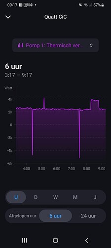

Isn’t this the moment where the heatpump is defrosting? At least, that’s how I check how often the heatpump defrosts. So the heatpump is taking thermal energy rather than providing. I guess that’s the rationale of the negative sign
Hi, good to hear! I haven’t seen negative values before for thermal power before. It’s just one of the other values that are copied as is. Could be what Jean Pierre says…

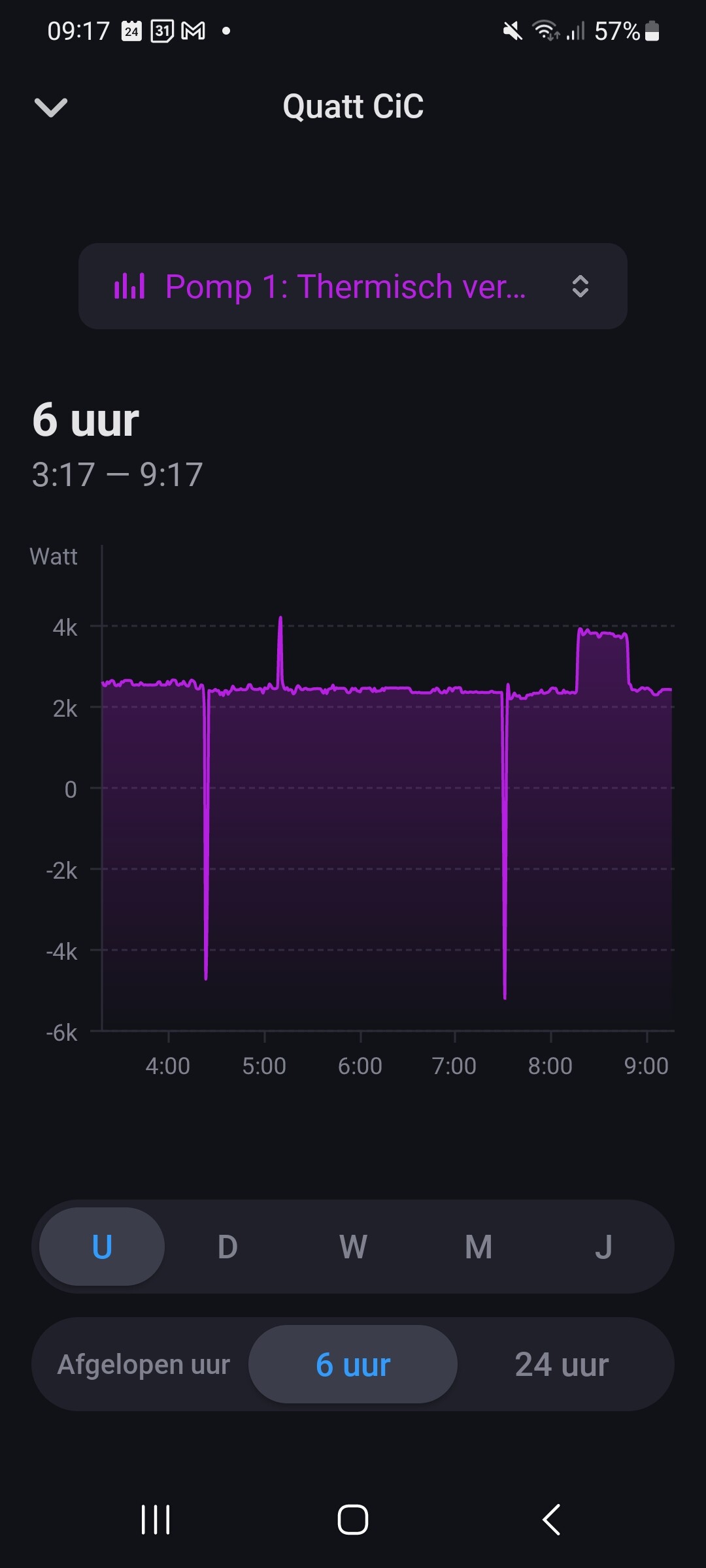

Here’s an example of defrost moments last night. As you can see, there are short ‘negative’ thermal power spikes. Is this the kind of negative values you are referring to?
Don’t think so. I see negative Thermal power spikes while heatpump is operational. I.e. water temperature is well above freezing and flowing (!)
What i do see is +40W Power Usage while heatpump is in Standby (no warm water flowing). I believe that to be a small electric heating to prevent freezing.
Maybe this is a question for Quatt. Looks like some operational transition (Power Usage rises, then drops and then return to original level) result in a negative Thermal power. A simple miscalculation ?
Do others see these patterns ?
This looks like regular defrostcycles to me. Water temperature and flow will remain at normal levels during these cycles. The heatpump will reverse the flow in these cycles and use the warm water to defrost the backside of the pump. Currently, there will be almost no frost at the backside of the unit due to the low humidity but I’d suggest you have a look once a while. At a certain moment you’ll see quite some ice that prevents the airflow. The defrostcycles remove the ice.
