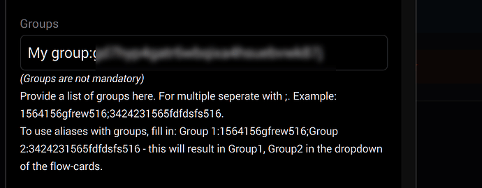

I have played around with Pushover app in Homey pro lately and have a few questions:
I want to make a group message in case of Alarm in Heimdall. I can get it to work with sending notification to one device at a time.
  1. How do i create a group with multiple devices to receive the notification?
  2. How do I make Pushover send loud Notification even if my iPhone is on silent mode?
Thanks in advance
Hi @Jakob_Thinggaard
I think I’ve got you covered.
  1. Groups
    In Homey, go to Settings, Apps section, Pushover, Configure and you scroll down a bit, you should see this section:
From the Pushover website and logged in, you will find the “Delivery Group” and from there you can create a group and get the “ID” from the website:
