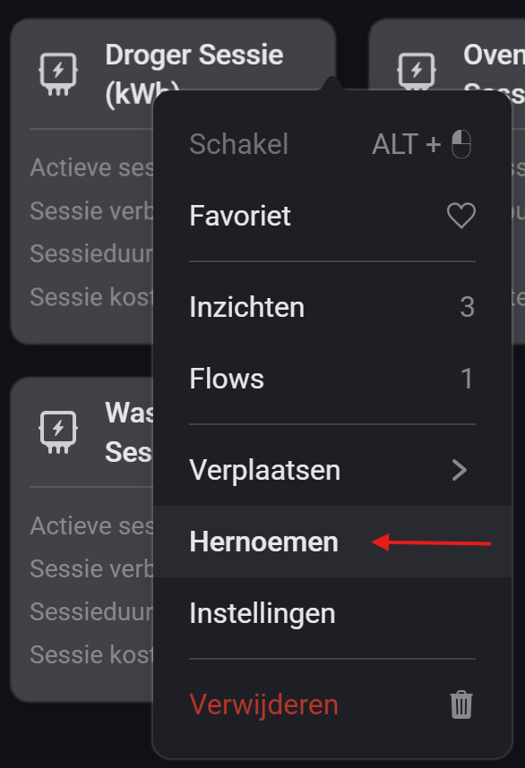

The session name/label is the session device’s name. You can change the device’s name in the web interface by right clicking the device tile and selecting Rename, or via the mobile app in the device’s settings:

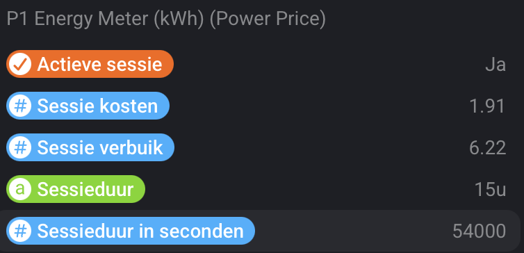

Hi @RobbertV, not sure whether you have plans to add the above on the short term. I want to fully transition from Flow Utilities to Power Price, as I find the latter more convenient to use. The one thing I am missing is the duration in seconds tag. Not sure whether you have some kind of planning in mind :blush: ?

Hi @RobbertV, thanks for adding this tag! It works great :grinning:.
New app update (:green_square: LIVE: 2.1.3):
NEW: Add duration in seconds capability for flows

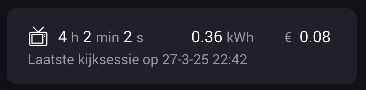

In addition I have a separate flow that controls the session information shown on my dashboard. For that purpose I use the status widget of the Enhanced Device Widget app that I customized via HTML (so not the Power Price widget):

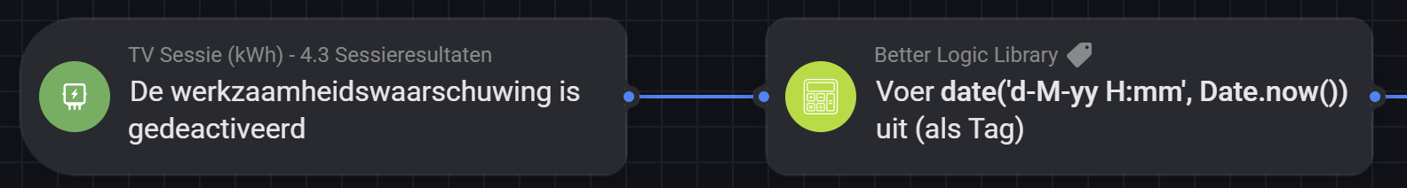

This flow is triggered when the session ends. As far as I understand the WHEN card that indicates the end of a session is the following, which I use:
Since I also want to show the timestamp of when the session ended, I use the Date.now() method to get the current timestap, when the flow is triggered, and format it in a specific format via one of the Better Logic Library cards. The downside of this method is that the original timestamp is not saved, so if I would re-run this flow (e.g. for testing) then the timestamp is replaced by a new one.
If I am correct the Date.now() method returns the Epoch value of the current (local) date/time. Since date/time formatting is a personal preference, if your app could make available that same value, it could be used for further processing by the end user. Though I also understand that a pre-formatted string/text based time stamp (like the one I am using) is more user friendly.
