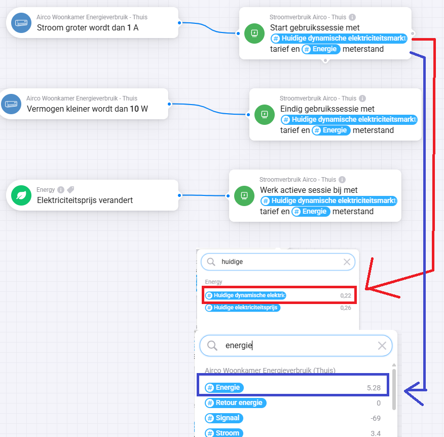

This is the flow i use, based upon the examples shared by you before.
Hereby the flow, apologies for my poor mspaint skills.
P.S. How do you recommend to summerize the session costs into a grand total, so at the end of the month you know how much energy in total (and costs) one device has used?
Your flow seems correct.
I think that the misperception is with the value of the energy variable for current price value. 0,22 is the placeholder text value. It normally shows the actual value, but in this case not. That is an issue on Homey’s system :sweat_smile:
Comparing my own situation; it displays als € 0,22 as well, but when looking at the actual price in the energy tab I’m currently at € 0,25.
