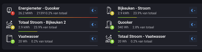

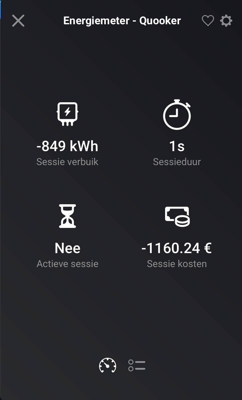

I now have -849 kWh for the Quooker and I would have spent -1160.24 euros. You understand, something is wrong, although I now have prices, I didn’t have that at all before. Now I don’t know if I should wait a bit until the Quooker has been on again, so that this information will adjust itself?
I also wonder if I’m using the correct #Tariefactief, #Energie, #Power?! I assume so, but I’m not sure because you have so much choice.
To make a proper comparison you need to provide a tariff price (f.e. 0.32) and a kWh meter count (f.e. Energie variable)
Make sure you have selected the correct socket variable (#energie), I had similar issues but that was due to comparing 2 different devices :sweat_smile:.
I think I’m doing something wrong. I can’t get it at a normal price. I don’t know what’s wrong, everything is, I think, good. I will send some examples, maybe someone sees what my problem is?!
I’m sorry I can’t help you. There are a lot of variables in these setup, this is only know or visible for yourself.
Seeing the first 2 screenshots are confusing to me as well, I don’t know what kind they are.
Seeing that Power Price device is reporting in MWh I came only suggest to check the data you provide this device. I think there is some configuration wrong in the given data.
Again this is something I can’t see from screenshots only in person for flow config you can check this. Hovering on the variable shows it’s source. (Via web app)

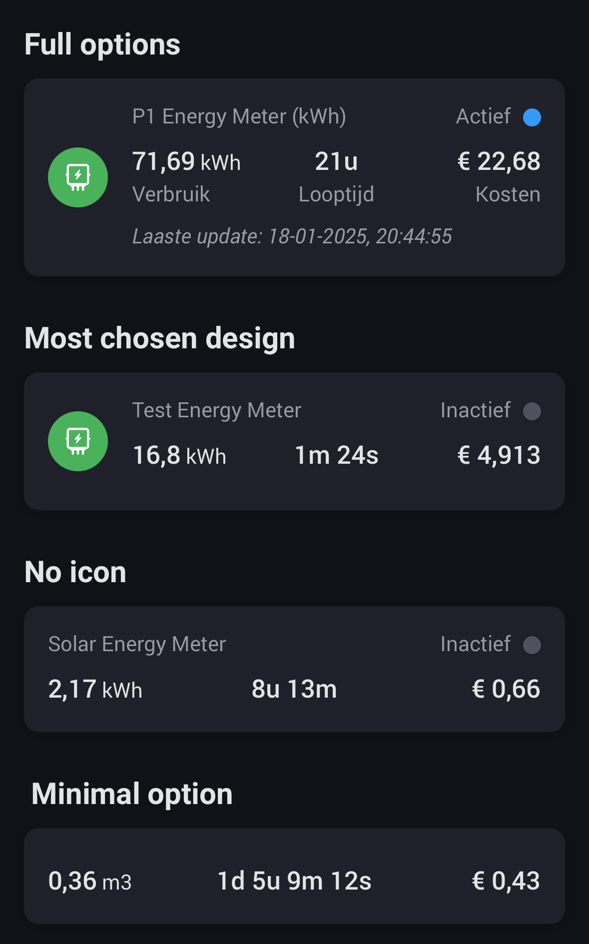

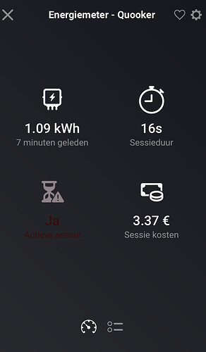

NEW: Dashboard device widget
OPT: Enable usage & costs decimals in device settings.
New homey dashboard widget options:
New advanced device settings:
FYI: @SunBeech
Nice features! :grinning:
Some minor observations:
  • The screenshot shows a running/active session on Jan 18th. The data included is of the last completed session (on Jan 14th), while the timestamp is of the last update of the active session (Jan 18th). This might be confusing. Would it not make more sense to display the timestamp of the last completed session? So all data elements relate to each other.
  • The duration field is capped when the icon is displayed.
Thanks for the quick feedback.
The timestamp is representing the last update of the widget, since this is live updating when this device setting is set and device is running. When this is not set by the user it makes sense to reflect the last end of a session.
Will have a look at both things.

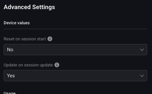

Are you referring to this setting in the session device? It’s turned off in my case.
If I would enable it, will the session values/capabilities be updated continuously while a session is running? Or only after a tariff/price change, as the setting’s description indicates?
Only when the update action card is triggered. As example when there a price change.
New app update (:orange_square: TEST: 2.1.1):
FIX: Widget timestamp to reflect latest session end/update
FIX: Widget timezone
OPT: Adjust widget styling & add loader styling
Note
Devices that not have triggered the update/end session cards yet show still the current date from updating the widget. Since this data will be stored from version > 2.1.1.
Also when a new device is added without having a updated or completed session this will be the default behaviour.
Really nice update @RobbertV
I use the widget to show realtime price of my Energy Meter and my Washer :slight_smile:

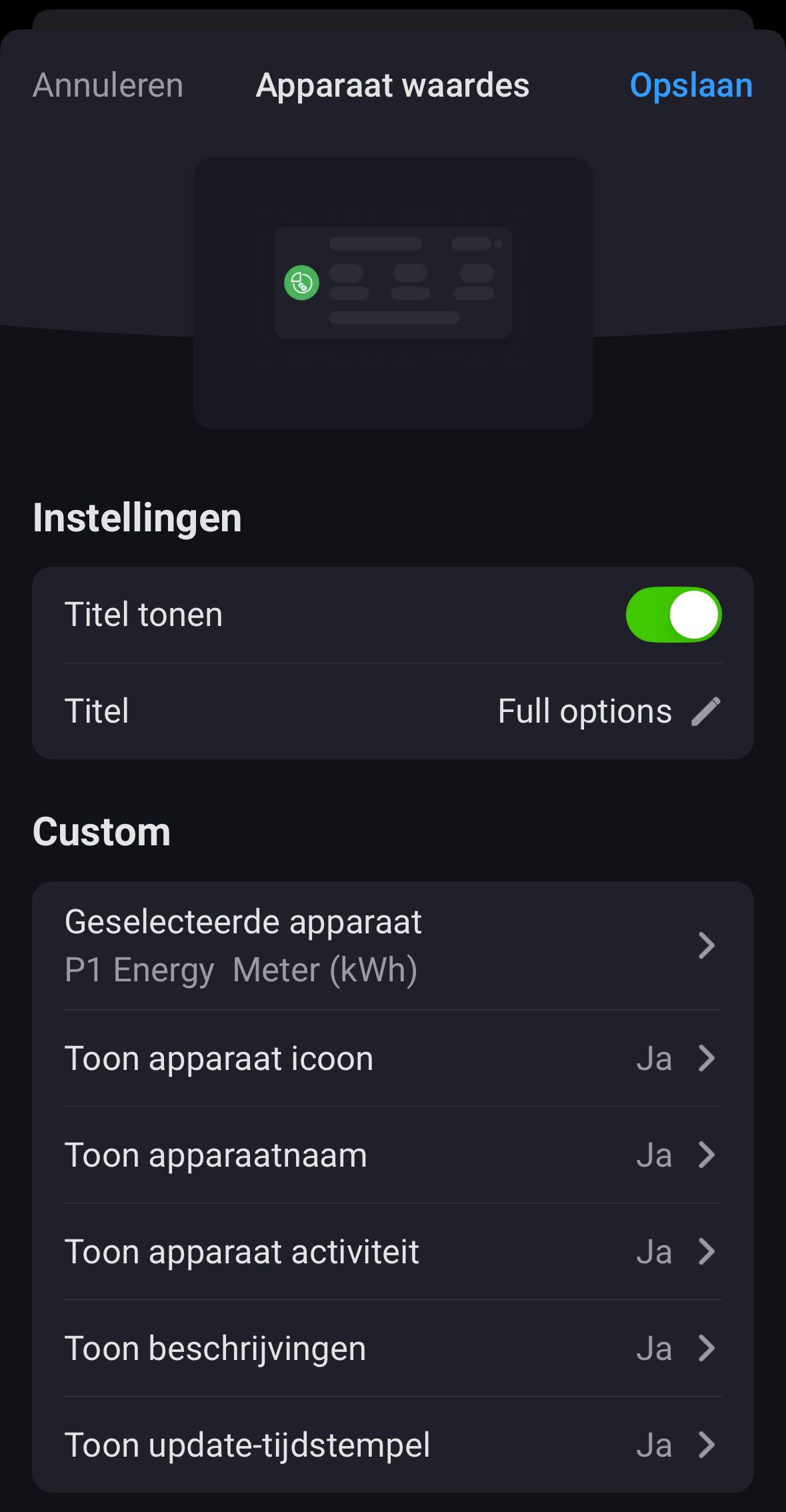

I set up my flow like this:
And in the device settings I have the following:
Thanks for the update!

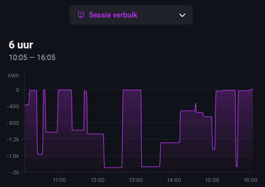

I have a question on how Insights work in relation to sessions. One of my Power Price devices summarizes the consumed energy (kWh) of a TV session.
If I look at the insights in the Power Pro device, it seems like the last session’s kWh value is continued until the start or end (not sure) of the next session. The result is that if, for instance I watch TV for 1 hour and then don’t watch TV for the next 2 days, the kWh value of the 1 hour session keeps being reported during the next days until I start a new session. This way it seems like I had that energy consumption during those 2+ days.
I would expect that the kWh value is only reported between the start and end points of a session (or only at the end point, as it is an accumulation). And that between sessions the kWh is 0.
But maybe I am misunderstanding how these insights work :blush:. Perhaps you could explain.
