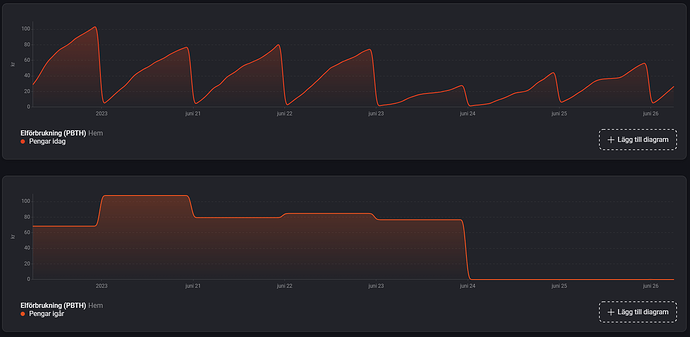

Hi @Gruijter Having a strange issue… For the last 3 days the cost for yesterday has been set to zero when passing midnight:
Top graph i todays cost, bottom is yesterdays cost.
Running v5.5.4.
Any ideas?
That is totally weird. What changed 3 days ago? Did Homey reboot or get a new firmware?
Does restarting the app or Homey maybe solve it?
Not that I know of…
Will start by restarting the app and check again tomorrow…
Restarting the app solved the problem of yesterdays cost showing as zero ![]()
