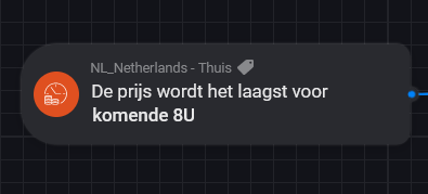

Somehow this card:
afbeelding
(Price is the lowest for the coming 8 hr) repeats the trigger every time after 7 minutes again.
for example, it triggers on 13:00 and 13:07.
Is this a bug or a deliberate (reminder) feature?
Sort of. A few minutes after the hour prices are fetched again. And that will again trigger the card. Is that causing issues for you?
