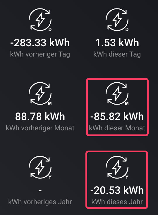

Hi Robin, yesterday I messed up a PBTH device (power summarizer). The only thing I did was to unplug the Smart Plug (Shelly Plus Plug S) when a load was on and plug it back after about 1/2 hour.
This has led to the fact that the energy values (kWh) and the costs now show completely wrong values for yesterday, this month and this year:
So I corrected the values “Start of month” and “Start of year” in the settings, but the values for yesterday, this month and this year are still wrong, because of the wrong value -283.33 kWh from yesterday:
Is there any way to correct this (the value from yesterday)?
